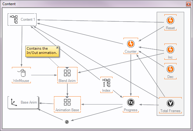

As opposed to the Hierarchy Editor, the Content Editor visualizes its content as a network of nodes rather than a hierarchy. There is no defined order in which information travels along the bindings. Instead, the validation mechanism inside Ventuz ensures that all nodes are correctly updated before rendering starts.
Two nodes are connected by a line if at least one property of one is bound to a property of the other. The binding relationship can be bidirectional in which case both ends of the line have an arrow head. To remove a binding, click on the line and a list of all bound properties opens. By selecting one of the entries, the respective binding will be removed. To remove all bindings of a node, select the node and press SHIFT + DEL or select Unbind from the Edit Menu.

When selecting a node in the Hierarchy Editor, the hierarchy node and all content nodes directly or indirectly connected to that node will be shown as well as all content nodes currently not bound to any other node.
The position of the individual nodes can be arranged by the user by clicking left mouse button and dragging nodes. Each node can be assigned a name by double-clicking on the node name or pressing F2. As with the Hierarchy Editor, parts of the network can be collapsed by clicking right mouse button on a node. To reach the Context menu, press and hold right mouse button for a few seconds.
Nodes displayed in the Content Editor can be grouped to Content Families to assure the relative positioning of the nodes in such a Family and to visualize a functional relationship. Select some nodes with the rectangular selection or by clicking on nodes with a pressed CTRL. Pressing CTRL + SHIFT + F will create a Content Family for these nodes and visualize this with a gray rectangle around them in the Content Editor.
Content nodes can be drawn in a Small version to save space in the Content Editor. Just press CTRL + T to toggle the size of a Content node.
