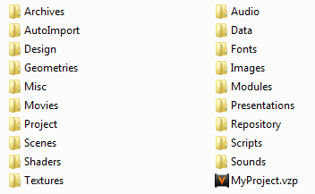

During startup of a Project in Director Mode, Ventuz will create all standard project folders such as Scenes, Images and Textures if they do not already exist.

The projects folder structure has a folder named AutoImport. Copying files into that folder will request a running Ventuz Presenter/Runtime to import the scenes and resources of that archive into the project structure. The automatic import of VZA archives allows the injection of new or changed scenes into a running presentation in Director Mode.
