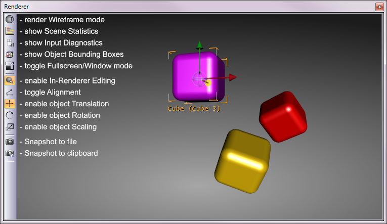

The Renderer Window shows the rendering result of the Scene/Presentation and updates it every frame.
Additionally some information can be displayed as overlay graphics like Performance Statistics or Transformation Gizmos for the in-renderer editing.
On the left side of this window is a column of buttons. A short hint to their functionality is printed in the screenshot above. These buttons are also available in the button bar at top of the Designer. This is necessary because in Fullscreen mode the buttons are not available in the Renderer window any more. To change between Window and Fullscreen mode press Alt + Enter.
If the In-Renderer Editing is enabled, it is possible to select/move/rotate/scale objects directly in the Renderer window by clicking and dragging the corresponding object handles. Note that in this mode the scene logic does not receive any Mouse and Keyboard events!
