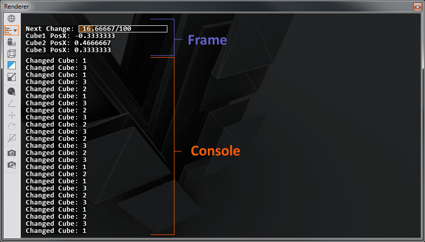

The Log Node can be used to debug large scenes and projects. It can print custom messages to the Performance Statistics. To see the outcome the Statistics as well as its User Log section must be enabled in the Renderer Window.
The Type property defines the way the message should be logged.
Simple markup can be used to change colors and draw bars. See Markup in Logging.
