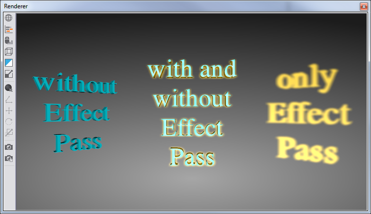

In the screen-shot below a glow effect was assigned to text objects. The glow is rendered in a separate render pass. Depending on the settings of the Filter Pass node only text, only glow or both, text and glow, are rendered.

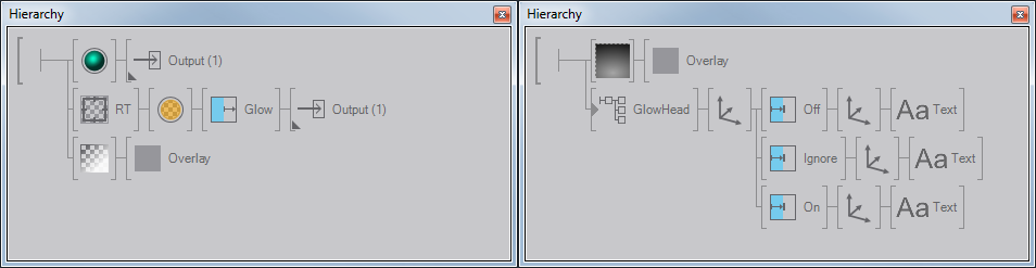

A possible scene setup for such a multi pass rendering is shown in the figure below. The GlowHead container has two linked Outputs: one for the normal pass and one for the glow pass. The normal 'blue' pass is traversed if the Filter Pass node is set to Off or Ignore. The 'yellow' glow pass is traversed if the Filter Pass node is set to On or Ignore.
