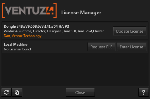

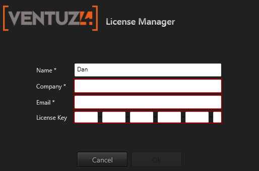

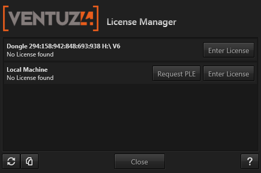

Upon start-up, Ventuz will check for a dongle with an already activated license. If it finds no such license, the Ventuz License Manager dialog will appear automatically. The License Manager lists all your Ventuz Dongles and your local machine and you can enter your License information and Key.
In order to activate a license, an active internet connection and a Ventuz USB Dongle is required. Once the license has been activated, the connection is no longer required. Only the dongle must be attached to the machine.
The activation process will create a license file on your dongle. Do not remove, rename, delete or otherwise modify this file! However, it is recommended that you create a backup of this file.
Please insert only one dongle. Licensing does not work with more than one dongle inserted in your computer. It is also recommended that you disconnect any external USB hard disk drives connected to your computer prior to licensing.
Update License
If you already have a Ventuz License and want to add additional Ventuz Features you can start the License Manager tool and update the Ventuz License with the new purchased Ventuz Features.

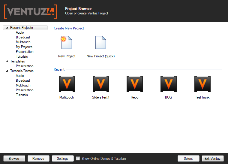

First Launch
Assuming an active license is available, you will be presented with the Ventuz Project Browser. You could create a new project and dive right into the software but first time users are strongly advised to open the tutorial projects and work through the individual tutorials. Due to the complexity and shear number of possibilities of Ventuz, trying to create a first scene from scratch can be frustrating at best.
The tutorials are designed as a step-by-step way of learning the fundamentals of Ventuz. Each tutorial builds upon the previous one and shows you by example how more and more complex presentations can be created.
