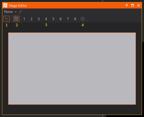

The Stage Editor shows a preview of the currently active Render Setup. To change the active Render Setup, select a different one in the drop down menu on the top-left corner or in the Ventuz Configuration Editor.
  • (1): Activate the Render Setup that is configured on the machine.
  • (2): Shows a preview of the whole Multimachine Setup.
  • (3): Override the MachineID configured in the Ventuz Configuration Editor for previewing different machines.
  • (4): Activate the Production Preview.

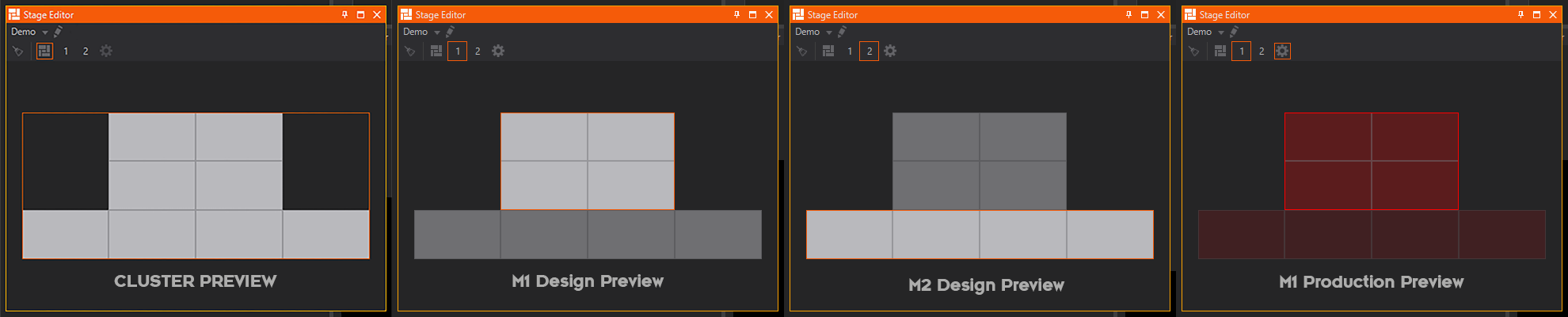

Three different preview modes are available:
  • Cluster Preview : Shows a preview of the whole Multimachine Setup, this mode is for designing content for a cluster. To activate the mode  click on the border or use the UI button (1), described above.
  • Machine Design Preview: Sometimes it is useful to just see one machine of a cluster to get a closer look to the content. To activate the mode  click on the desired machine.
  • Machine Production Preview: This mode shows the real production output that your displays, projectors, etc. will get fed with. To activate the mode shift + click or use the UI button (4) described above
