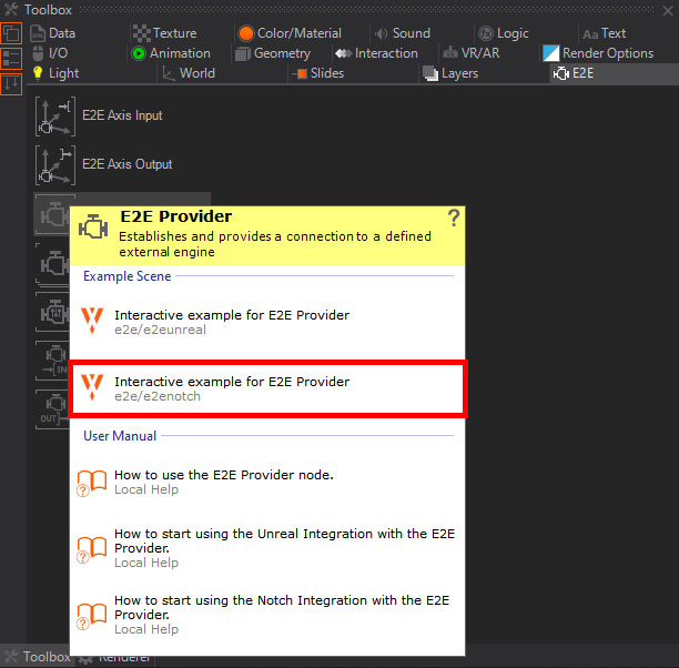

Create a new Project, name it for example, Notch E2E and create a new scene. Open the Ventuz Toolbox, click on the E2E tab. hover over the E2E Provider node, and press F1. This will show the contextual help options; click the Interactive Example for E2E Control for Notch:
A new scene will open. In the background, Ventuz automatically copied a the sample Notch Block to your current project folder and opened it. You can safely close the help scene.

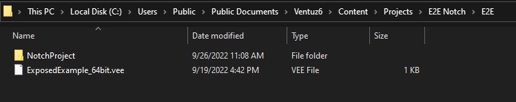

The needed Notch block is now copied in your project location and can be found in: YOURPROJECT/E2E/NotchProject/
We created a project called E2E Notch in the default location. Therefore we will find our ExposedExample_64bit.dfxdll inside the NotchProject folder:
Whenever we reference to load the Notch Example Block, it can be found there.

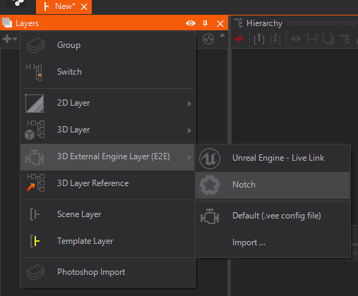

Add an E2E Notch Layer. To create the layer, click on Layer -> 3D External Engine Layer -> Notch

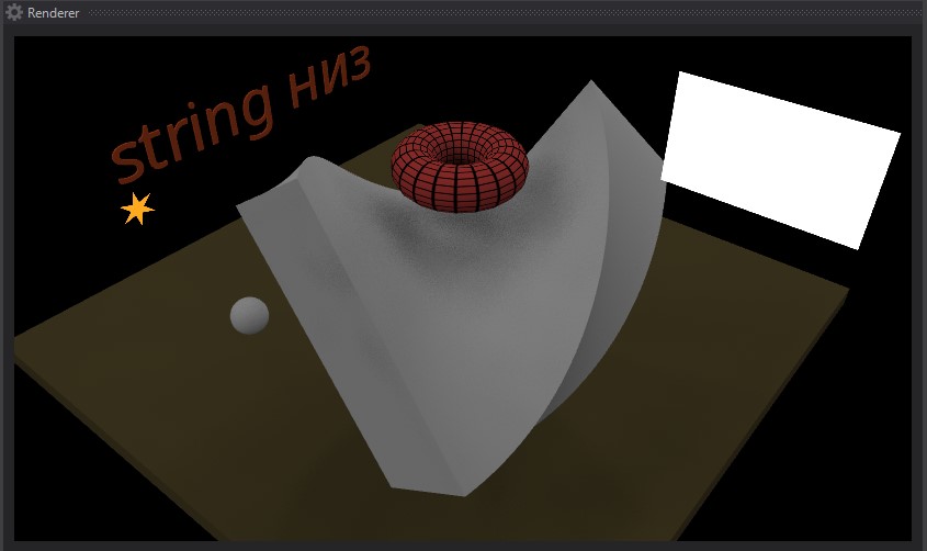

As soon as the Notch Block is successfully loaded, you will see its content rendered:

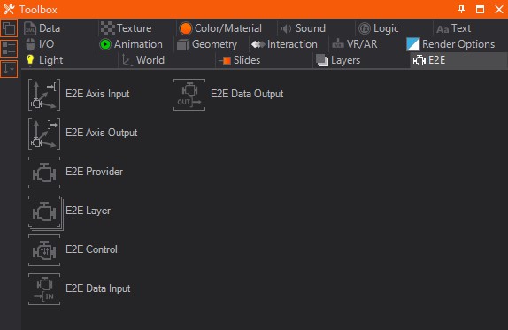

To access these exposed values we need to make use of the E2E Data Output Node. The E2E Nodes can be accessed trough the Toolbox or using the Alphabetical Searchbox:

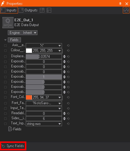

Select the Notch Layer and drag&drop the E2E Data Output Node into the Content Editor. Ventuz can automatically synchronize all of the Notch Block's exposed parameters. Simply click the Sync Fields which can be found at the bottom of the Property Editor:
The above screenshot shows the synchronized fields.
Now you can bind the exposed values as you would with any Ventuz Scene. This example covers most of the available types such as strings, floats, integers, color and so on.

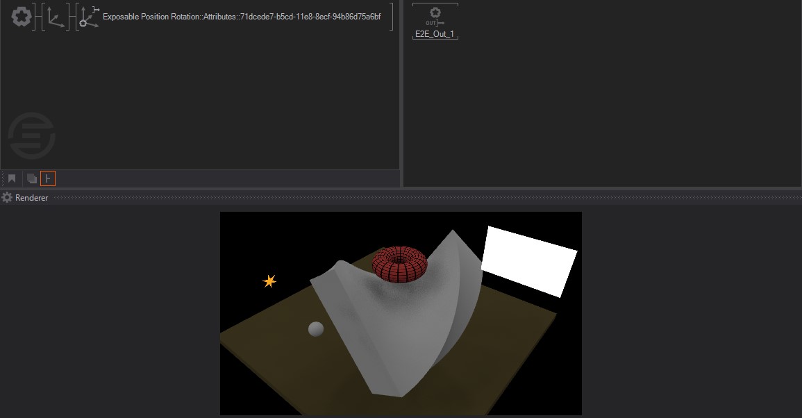

Select the Hierarchy Editor and create an Axis. Create an E2E Axis Output Node - either by drag&drop the E2E Axis Output Node from the Toolbox or using the Alphabetical Selection, behind the Ventuz Axis.
Open the Notch editor and load the ExposedExample.dfx and find the property for the Exposable Null for the torus. Select and copy the whole Unique Identifier line into the clipboard using ctrl+c or click and chose Copy.
Now go back to Ventuz Designer, select the E2E Axis Output Node, doubleclick the Axis to rename it and paste the copied Unique Identifier to replace the name by using ctrl+v.
The scene will look similar to this:
You can now change the values for translate XYZ, for the Ventuz Axis, and the torus will move according to your changes in real-time.

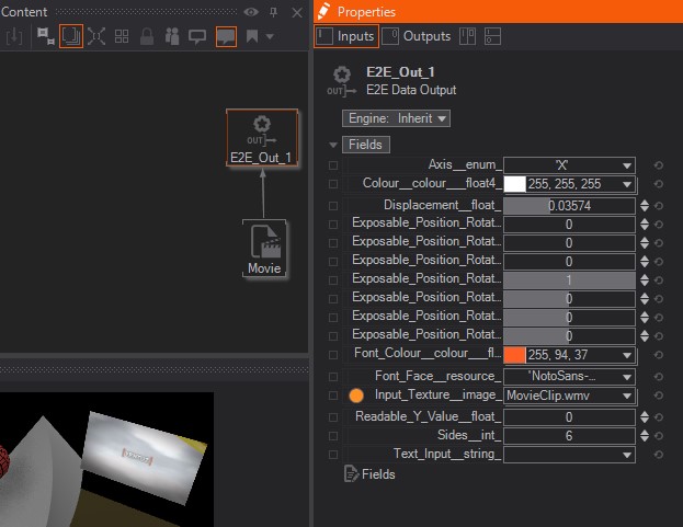

From within Ventuz, it is possible to send textures to a compatible Notch Block like live video, images and movies. With the example scene you can simply create a binding from the output, of a movie clip node, to the Input_Texture__Image_ of the E2E Axis Output Node:

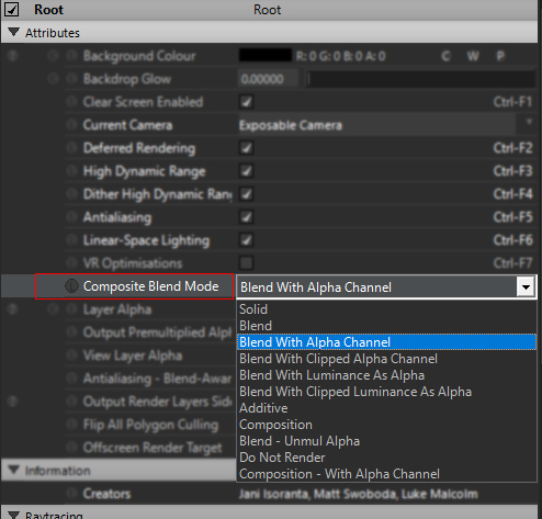

Keep in mind, that the Composite Blend Mode will be disabled by default for any custom made Notch Block. Therefore, if you plan to have your Notch Block blend with another Ventuz 3D layer or another Notch Block, you will need to change the Composite Blend Mode from within Notch before you compile the Block for a media server. You will find this setting in the Notch Root properties -> Composite Blend Mode
