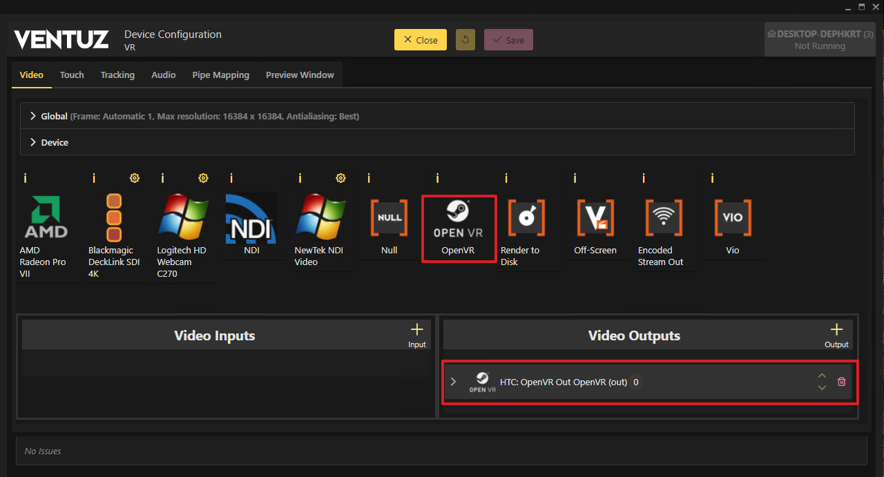

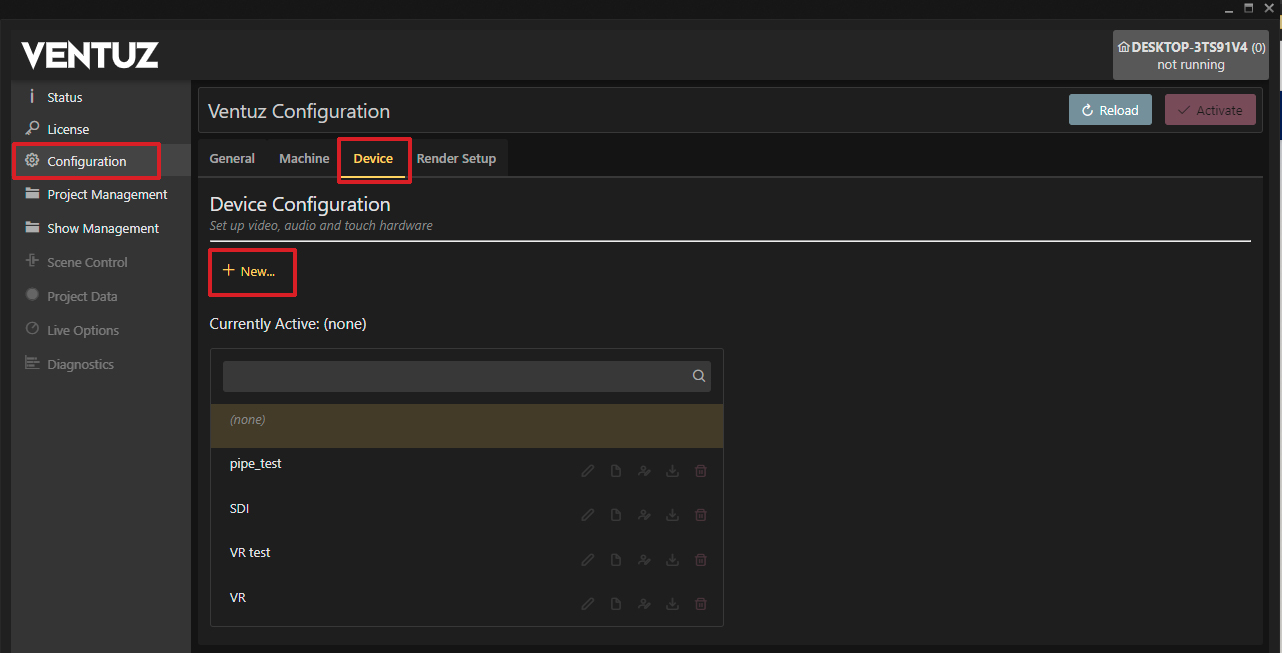

  1. Open the Ventuz Configuration Editor.
  2. Create a new Device configuration by  clicking the + New Button.
  3. Name the new Configuration and click Create.
  1.  Drag&Drop the OpenVR into the Video Outputs Field of the window.
  1. Save the configuration and activate it.

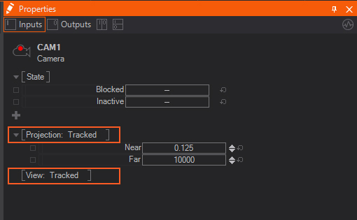

  4. Create a Camera Node in the Hierarchy Editor panel.
  5. Select the Camera in the Hierarchy Editor panel.
  6. In the Properties Panel switch the Projection and View by selecting Tracked in the drop down menu.
From here, the Camera properties can be adjusted for the VR-Camera. The camera position is directly in the center of the scene inside of the rotating "V". The Offset of the Camera must be set for the HMD to correctly view the scene.

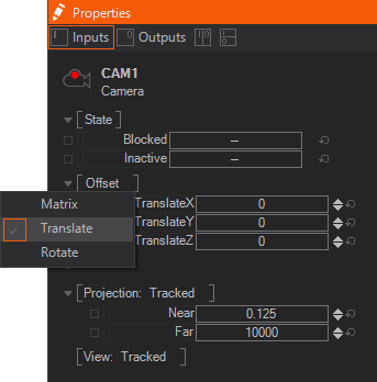

  1. Select the Camera and in the Properties Panel
  2.  Click the + and select Offset.
  3. Change these position values to relocate the HMD in 3D space until the desired position is set.
  4. Type in [X,Y,Z] Values and the rotating "V" should appear in front of the User.

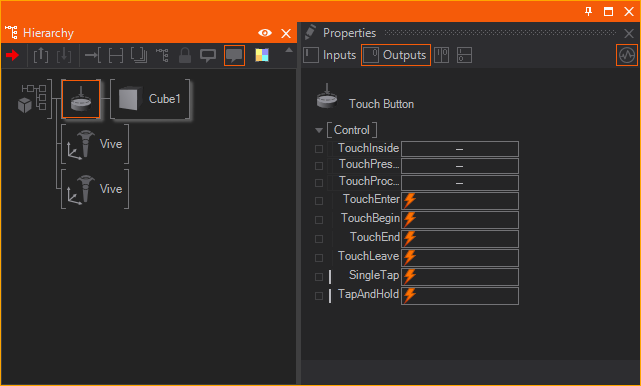

In order to add interaction in a Scene, the controllers are needed inside of the Scene.

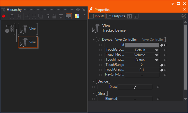

  1. Add a Tracked Vive Controller Node to the Hierarchy.
    • One Controller should be visible in the HMD when the Controller is held in front of the User.
  2. In order to add the second controller, a second Tracked Vive Controller Node and change its Id property to 1.
If your second controller isnt working then you probably forgot to set the ID. The left Controller is usually ID 0 and the right ID 1
By changing the Touch properties, the Touch Behavior of the controller can be changed, including the Method of the Interaction, Trigger Button, length of the Touch Ray, or the Gravity that is affecting the Parabolic Touch Ray.
To interact with objects, an Object Based Interaction Node placed in front of the desired objects in your Hierarchy such as a Touch Button or Touch Transformation Node.

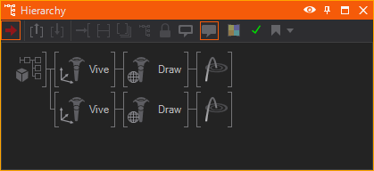

The appearance of the controllers can be changed. The Tracked Vive Controller Node draws the whole Controller and can be affected by a Material to apply textures or color the controller.
The Draw Vive Controller Node enables more finite control of the drawn controller by changing the controller mesh or by editing the existing controller mesh.
Place the Draw Vive Controller Node behind the Tracked Vive Controller Node
A Draw Touch Ray Node draws a Ray from the controller(s).
Use the same Id as the desired controller.
A Material can be placed in front of this node to customize its appearance.
