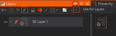

In addition, the Layer Editor can be exposed in any custom Layout by marking the Layers option into the View menu, or by using the keyboard shortcut CTRL + F5.
The Layer Nodes can also be used inside the Hierarchy Editor to save some screen space. Check the Window Option in the Layer or Hierarchy Editor.

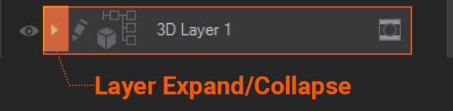

Layer Collapsed This arrow-shaped icon indicates that the layer is collapsed, its properties are not shown in the Layer Editor. After pressing it, the arrow points downwards, meaning that the layer is expanded and its properties are displayed in the Layer Editor. Group layers which contain other layers, behave in the same way, so expanding them will show the layers inside the Group. They can be expanded to access other layers or properties, and so on. This is the area that gets colored when using the color tool in the Layer Editor toolbar.

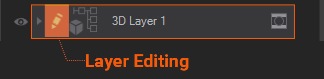

Layer Editing This pencil icon enables editing of the layer. This is applicable for 3D layers in particular, because it enters the hierarchy for that particular 3D layer, where 3D scenes can be created and worked on. For 2D layers, this function opens the content in the Content Editor, allowing for the creation of complex Logic and data connections, for instance. You can also enter a 3D Layer container by clicking middle mouse button .

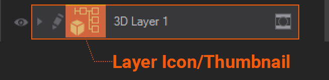

Layer Icon/Thumbnail This area displays an icon to show the type of layer, whether it is a group, 3D or 2D layer, etc.. Furthermore, for most 2D layers it also acts as a quick way to edit its content. By double-clicking on the icon, a contextual editor will appear to select the image file, adjust the color or gradient, etc... It also creates a small thumbnail of the layer current content.

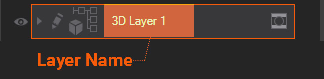

Layer Name This area shows the current layer name, it can be edited by double-clicking on this area. The layer names assigned by the software by default also indicate the type of layer.

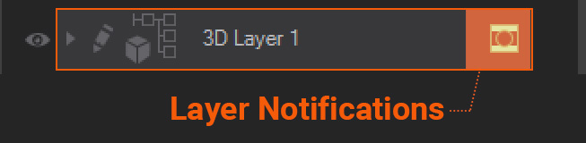

Layer Notifications Some icons will appear on this area to reflect the options selected in the toolbar, like lock, preview/program visibility, etc.. It will also show an icon whenever effects are applied to the layer.
