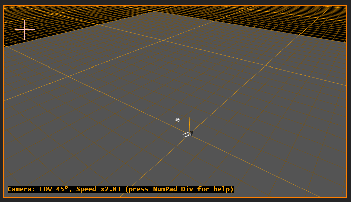

Lightsources are immaterial and therefore no geometry is rendered for them. To see the orientation and shape of a light source activate the show non-render objects.

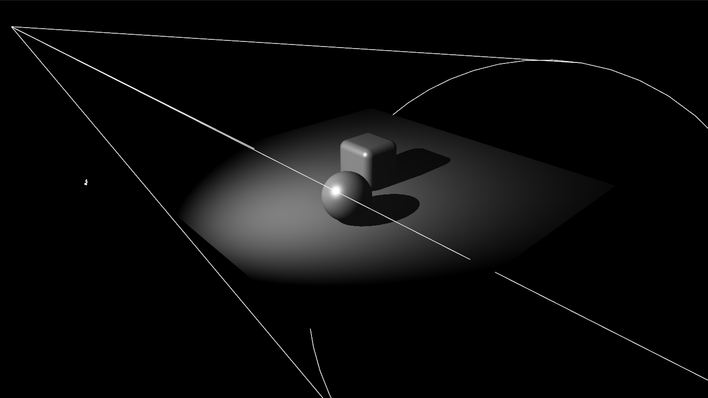

The Spot light differs from the point light in that it only emits light in a cone shaped volume instead of all directions uniformly. The InnerCone specifies the radius of the region that is lit at full intensity which then decreases to the OuterCone radius where the light influence of the spot ends. It also simulates brightness decreasing the farther away something is from the spot (Attenuation) and the more it is offset from the center axis of the spot towards the boundary (FallOff).

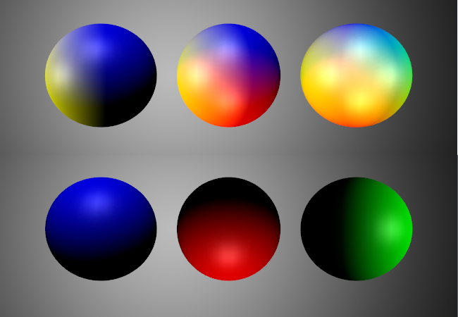

The example below shows the same scene lit by a Direction light coming hard from the left, a Point light above the scene and a Spot light coming from the right.

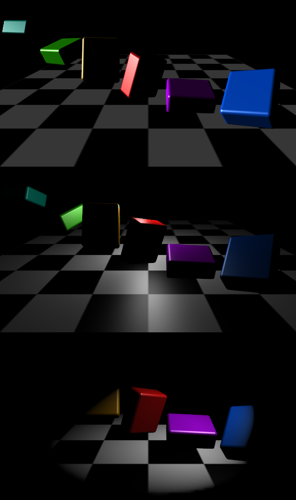

Multiple lightsources can be added to a scene, for example as main and fill lights as often used in a photo shoot. However, they can also be used to light separate parts of a scene differently. For example, a spot light may be used to light only one object but not affect another object, although it would theoretically be in the cone of the spot. Instead the second object could be rendered using a completely different light setup.
Lightsources are special in that they affect all nodes that are rendered after them, not just their child nodes. They are not deactivated once their subtree has been processed.
Each light source has an Input Property Index which specifies whether the light should be used in addition to existing lights (Next) or should replace the last activated light (Override). To limit the effect of light sources to certain parts of a scene, Lighting Group nodes can be used. If their Inherit property is deactivated, lights defined outside the lighting group will have no effect on the objects rendered within the lighting group. The example below shows a scene with four differently colored light sources. In the top row, each light source illuminates each sphere that comes after it in the rendering order. In the bottom row, Lighting Groups have been used to isolate each sphere together with one light source in a separate group.

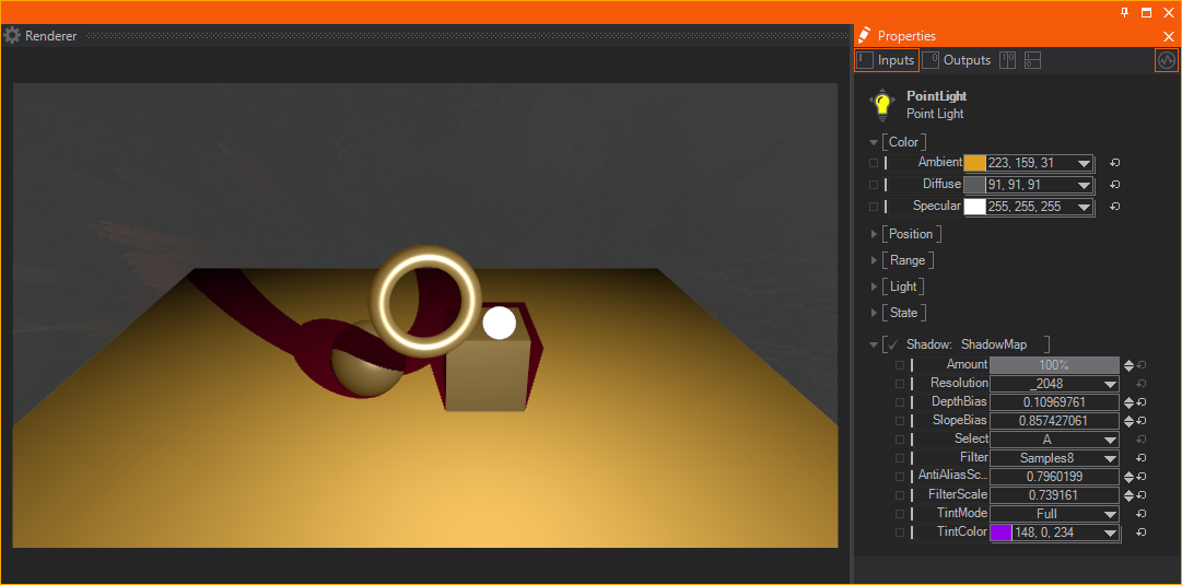

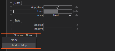

For each lightsource you can enable shadows. Shadows in Ventuz are based on Shadowmaps.

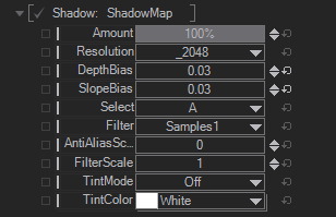

Click the Shadow drop down menu in the Lightsource Properties and select Shadowmap to enable Shadows.
You can adjust the Properties for each lightsource individually.
The Amount is the overall intensity of the shadows. Resolution is the shadowmap resolution and should be as small as possible. With the DepthBias and SlopeBias you adjust the sampling of the shadowmap (see How To Use Shadows for more details). You can define to have the shadows in a group by the Select drop down menu. You can set the Shadowmap in the A or B group or have it off any group. The grouping works together with the Shadow Filter. The Filter drop down menu affects the shadowmap filtering and you can select between Samples 1, Samples 4 and Samples 8. When Samples 4 or Samples 8 is selected you can also adjust the quality of the sampling by changing the AntiAliasScale and FilterScale. If the values for the Scales is 0 and not bound, the sampling scale is completely turned off in the shader and therefor the performance increases.
The Pointlight needs to render one shadowmap for each of its six sides. This can affect the performance a lot! The shadowmap resolution becomes even more critical here!
With the help of the Tint properties you can tint your shadows. This will apply the specified TintColor to the BaseColor of the affected objects after multiplying it with the AmbientColor of your light. The TintMode defines how the Tint should be applied: Full will apply the Tint Color everywhere in the same amount. Attenuated will linearly fade out the amount of the Tint over the distance to the light source.

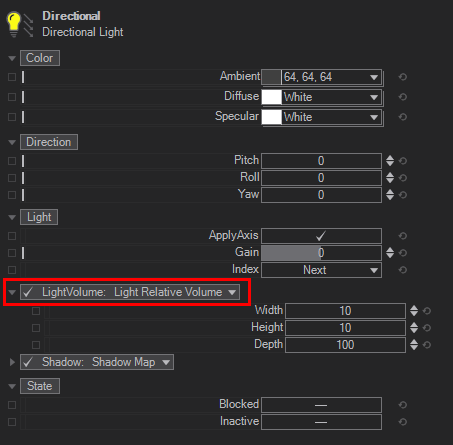

You can define a shadow volume for the directional light source. Enable the LightVolume by selecting the Light Relative Volume from its drop down menu.

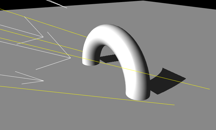

The so called shadow volume can be visualized by enabling the Show non-render objects button in the top bar.
This will show the shadow volume by rendering infinte lines, which visualize the volume bounds. By using the Width, Height and Depth properties, you can adjust the volume's boundaries. Everything that is inside the volume will act as a shadow caster. It is therefore possible to have just a part of an object throw a shadow, as long as it is inside the volume. See the screenshot below:
This way you can limit the boundaries of a directional shadow. Instead of using the whole scene boundaries to create the shadow map, you can now limit it and therefore safe shadow map precision, therefore performance. Before, you would need to increase the shadow Map Resolution to have at least more details when using a very huge scene. Now you can safe performance and or the resolution, by defining the volume for the directional light shadow.

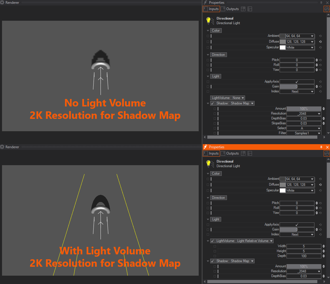

Below we compare a scene, one without- and one with LightVolume used. The scene is VERY huge because the groundplane has a size of 400 units. The torus is compared really small:
Both scenes use the same settings for the Shadow Map Resolution of _2048, same Directional Light Source and positions. The upper screen shows the Directional Light Source without the LightVolume while the lower screen shows the exact same Directional Light Source with the LightVolume enabled and adjusted to be at 10x10 units (the boundaries are indicated by the yellow lines).
While the upper screen result is more of a blocky and pixelated shadow map, compared to the crisp and high resolution shadow map for the other, you can see, that without a defined LightVolume the whole scene (in this case the 400unit ground floor) is taken into account for the shadow map calculation. Therefore you have less pixels in the same shadow map available - since it has to cover the whole scene. If you define a LightVolume for the shadow map calculation you can define specific areas that really advance of a shadow map or are point of interest, while not wasting the space on the shadow map or resolution in other areas in the scene, which are out of focus or point of interest.
