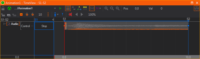

The category Audio Control provides properties to start, pause and continue the audio playback. The property Control can be bound to a Keyframe Animation node to control the playback in the time-line of the Animation Editor.

The category Audio Control provides properties to start and stop the audio playback. The property Control can be bound to a Keyframe Animation node to control the playback in the time-line of the Animation Editor. The property Ordinal specifies the audio device that should be used for playback.

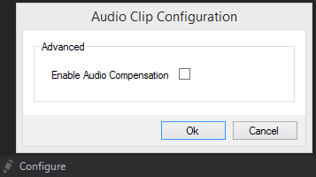

Audio Compensation
Usually audio and video have slightly different timing. This may cause audio timing to drift compared to the video output. This can be especially bad if the video system reports an inaccurate timing, which is worst with DVI outputs. On SDI outputs, audio and video are always perfectly synchronized.
Audio playback nodes get their timing from the sound card. By binding the control of the audio playback node to an animation, the animation takes over the timing, and now the audio playback gets their timing from the video subsystem. Also, movie clip nodes tie the audio timing to video. Now audio and video can drift apart, and this is where audio compensation comes into play.
If audio compensation is enabled, Ventuz will try to speed up or slow down audio playback just slightly to compensate the drift between sound and video subsystem. If it is disabled, audio will skip to the right position when the difference gets too big. This can be controlled by pressing the configure button in the property sheet.
Unfortunately our current implementation of audio compensation can get confused when the frame-rate is low and unsteady. In such cases wobbling can be heard and audio compensation should be disabled.
