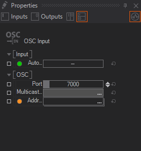

The Property Editor lists the input and output "parameters" of the node selected in the Layer Editor, Hierarchy Editor or Content Editor. It also displays the properties of selections in other editors, such as the Animation Editor or Project and Scene Data. Only the properties of Nodes can be bound to other nodes or can be animated. Other properties shown in the Property Editor can only be viewed or edited.
The following screenshots shows the properties of a Rectangle node:
The top row of buttons selects whether only input, only output or both property types in a split view should be shown. The button on the top right is the Monitor Values button. When activated, the user interface will update the shown values every frame. This causes a small performance penalty but is great for understanding what is happening in a scene. When deactivated, the values are only updated when the selection changes or the user chooses another of the four view buttons (input, output, splits).
You can select properties by  clicking them. When holding SHIFT while doing this you can select multiple properties. Using CTRL + Q selects all properties in the same Category or Property Group. Then you can either  click and hold the selected properties to bring up their Context Menu and manipulate all of them at once or use an according shortcut for this.

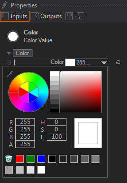

Editing Color Values
Color Values can be changed in several ways and somehow exceed the ways you can change values of other types. You may choose whichever is most comfortable. By clicking the downwards arrow of the Value Column a small window opens, where you can edit the current property.
On the top, you can change the current Hue of the color with the help of the Color Circle on the left. Moreover you can control its Saturation and Lightness with the Color Square on the right. Below you see the RGBA values which you can change to any other integer value in the Property Editor. Next to it, there is the representation in HSL which works the same.
On the right, the Color Preview shows two colors defined as a square with an inner and outer area. The color in the outer area is the formerly picked color whereas the inner square shows you a preview of the currently picked color. You can drag and drop both squares to the bottom of the window and add them to the Color Presets collection. The Color Presets shows the most recent colors picked, they can be overwritten or deleted by dragging them into the bin.
Whenever you change one of the representations, not only the Renderer updates the Color and already takes notice of that but also all other representations inside this window will update their values.

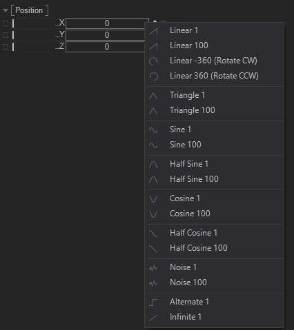

Animate Floating Point Numbers
Floating Point Numbers can be animated directly inside the Property Editor using a generic animation similar to those of the Mover Nodes. All other value types need to be bound to either the Output of another Node or to a Keyframe Animation's channel. To create a Floating Point Animation click the button on the right of the property's value's box (it appears when hovering over the property). In the appearing dropdown you can choose a function for the animation and one of several presets for it. See the Mover Node reference for more information on the different functions.
Note that this animation will work like a Mover Node set to Absolute Mode. Thus it is animating synchronously in a cluster. If you need other modes click the extract button next to the property. It appears as soon as you have configured an animation in the Dropdown.
To change the values you can  click to uncollapse the property. The Type changes the function of the animation, Min and Max adjust the range, Duration will change the time for one iteration of the animation and Offset defines an offset for the start of the animation.
The Infinite function animates the floating point number in relation to the Cluster Clock. On systems that need to run in long-term this will eventually get inaccurate due to the precision of the floating point numbers.

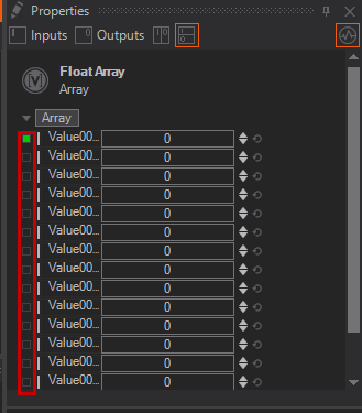

Exposing

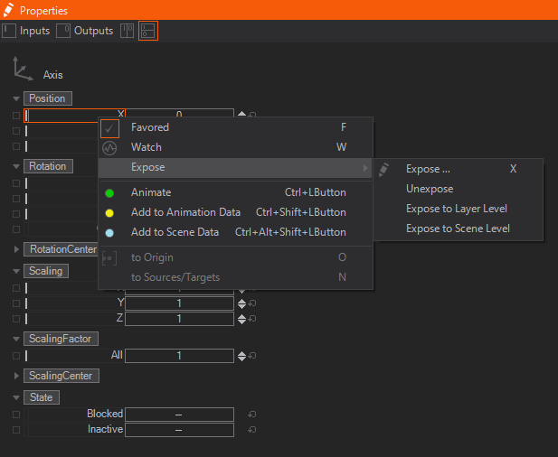

The small square on the left indicates the exposure state of the property. By double-clicking  on it or hitting the X key when the properties are selected, the user can assign a name, category and the default value of how the property should appear on the parent container level.
Exposing Properties
While a Container or Layer is primarily designed to hide the complexity of its implementation, there are usually some properties of the encapsulated nodes that need to be adjustable from outside the Container. A button may allow the user to change its color and label, a movie player my require a file name to work correctly and so on.
Any input or output property of a node inside a Layer or Container can be made available on the outside as a property of the Container itself by exposing it.
To expose a property, click  on the name of the property in the Property Editor and choose Expose/Edit... from the appearing context menu. The name and category of the property, as it appears on the Layer or Container, can either be kept the same as on the original node or be reassigned in the dialog that opens. Press OK and the square to the left of the property name will change to green, symbolizing that this is now an exposed property. Note that exposed property names have to be unique within a container. Exposing two properties with the same name will not only confuse other Ventuz operators but can also disrupt the binding logic.
To quickly expose a property without changing its name or category, click  the small square to the left of the property. To quickly "un-expose" a property, click  on the square. A double-click will bring up the Expose dialog.

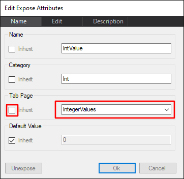

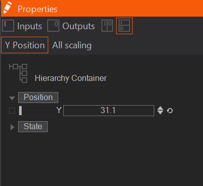

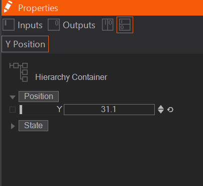

Property Tabs
With Ventuz 6.6 we introduced Property Tabs. These allow to sort your properties into custom tabs. To do this simply doubleclick  the expose button and a new window will pop up.
If inheriting is enabled the exposing will appear on the same tab like the exposed property. To change that uncheck the according checkbox. When changing the name you can also use the dropdown to choose from a list of already present property tabs of the current container.
After typing in the name of the tab you can hit OK, and now you can find the new tab on the top of the Properties Editor at the according container.
If you want to add multiple exposed parameters to one tab, you need to expose the needed properties on the node itself first. Then jump up one level and mark all of them with shift + Left click .
Right click  one of the selected items and add them to an existing tab, create a new one or even remove it from the current tab.
This only works on selections on the container/layer - not on the exposing node itself.
The selected tab will always be highlighted in Orange.
Data items with no allocated tab, will be always displayed. Regardless of the tab selected.

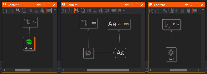

If properties are exposed or bound to other nodes, it might be necessary to see where a value actually comes from. It is possible to navigate to these source nodes via a context menu in the Property Editor.
If one wants to navigate the node that exposes its properties to the higher container level, a long click  on the interesting property will display a context menu. Not all menu entries are enabled. This depends on the exposing level and the binding state of the selected property. For the navigation in an Exposing hierarchy the menu entries to Origin and to Origin Root are useful. to Origin navigates inside a container to the node that exposes the selected property. This can be any of the Ventuz nodes. to Origin Root navigates to the root of an exposing chain over multiple container nodes. In this case, the destination node can be any of the Ventuz nodes except the container nodes.
If an input property is bound, the menu entry to Source Node will navigate to the node which is bound to the selected property. The navigation to Property is only possible if the Favored option is enabled. In this case, a Hierarchy node inherits the favored input properties of all bound nodes for display in the Property Editor. Selecting to Property on such an inherited property will navigate to the real owner of this property.

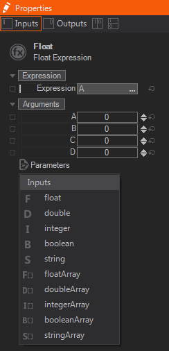

Some Nodes like Expression Nodes, OSC Nodes or DMX Nodes can have a user-defined number of Properties. The ability to add or remove properties is called a Custom Model. A click on the button at the end of the properties list brings up a drop down with a list of available property types. The available types depend on the node. Properties can be renamed by double  on the property name label, or select the property and press F2.
