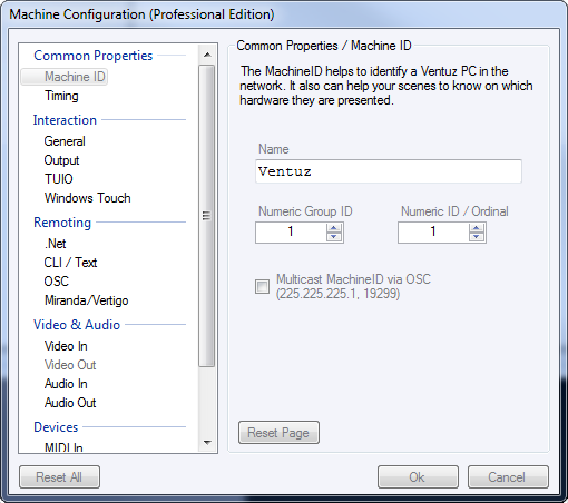

In order to set up a clustered environment, check the Enable Cluster Clock Synchronization checkbox in the Machine Configuration on all machines in your cluster. You can do this either under Menu/Tools/Machine Configuration in Ventuz or by using the Machine Configuration Tool in the Ventuz Technology program folder.
Make sure that all machines which are supposed to use the same cluster clock have the same Group ID (must be greater than zero!) and a different Machine ID applied. The machine with the lowest Machine ID within a group will serve as the Cluster Clock Master. The algorithm used for interchanging the cluster clock information is easy and transparent: Every machine sends out its current time right after it has finished rendering a frame but before the vertical retrace of the graphics card has occurred. As soon the vertical retrace releases the renderer from its wait state every machine receives all clock information from all other machines - include its own. Every machine simply selects the clock from the lowest machine-ID is has received and adds a value of one to enter the next rendering cycle. This makes the lowest ID the Master but if the master stops rendering or has been disconnected from network another machine will become the Master on-the-fly!

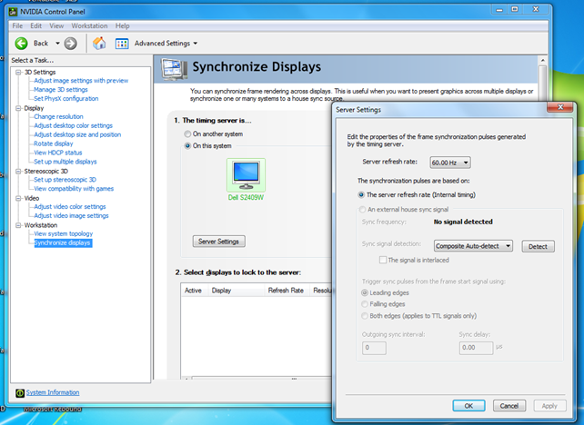

Frame synchronization is the process of synchronizing display pixel scanning to a synchronization source. When several systems are connected, a sync signal is fed from a master system to the other systems in the network, and the displays are synchronized with each other.
The NVidia Quadro® G-Sync offers frame synchronization to enable multiple systems synchronizing frame rendering across multiple displays plus synchronizing one or many systems to a common sync source.
Frame lock uses hardware to synchronize the frames on each display and to redraw onto multiple displays at the same time. When Ventuz is displayed across multiple monitors, frame-locked systems help maintain image continuity.
Frame locking several systems requires that the systems are connected with the sync signal fed from the master to the other systems in the group. A network of frame-locked systems can be synchronized by connecting the master system to an external synchronization source.

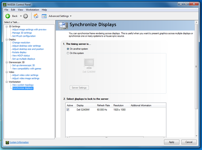

On all other systems go to Synchronize displays and check this server: "Select displays to lock to the server"

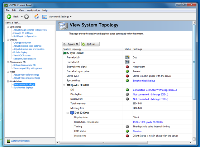

Check on the "View System Topology" tab that the framelock sync puls is "Present".
