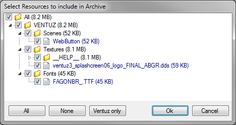

In order to export a Ventuz Presentation, open the main scene in the Ventuz Designer. After a final review of the scene in the Runtime Layout, select File/Export/Presentation (vpr) from the main menu. A resource selection window will request which resources should be included in the VPR file. In most cases, the automatic resource selection does not have to be modified and can simply be confirmed by pressing Ok.
This dialog shows all resources used in the exported scene including resources of sub-scenes. If any additional resource are required which are not automatically selected use the Resource Linker Node to add them to your scene.

A Ventuz Archive is usually used for scene exchange between users, Ventuz Projects or workstations. A Ventuz Archive can be compared to a VPR except that File/Export/Archive (vza) has to be selected from the main menu.

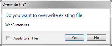

In order to import a VZA archive into an existing Ventuz Project, open the project and select File/Import/Archive (vza) in the main menu of the Ventuz Designer. The following Resource Selection dialog will ask which resources should be imported into the project. If a resource already exists, the user is asked whether to overwrite or keep the file.
