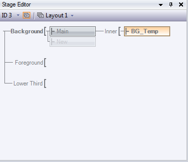

When working with nested scenes and Remoting, one can easily lose an overview of which scene is rendered where. That is why Ventuz provides the Stage Editor (Ctrl-F12):
This editor shows all scenes in memory along with their available ports. Scenes can be loaded by Ventuz Designer, by a Scene Port or by Remoting. The editor uses a tree-like visualization similar to that used in the Hierarchy Editor. Drag&Drop makes it easy to assign scenes to Ports and track assignment changes via Remoting. The scenes currently opened in the Designer as well as the current Layout scene are visually marked in the Stage Editor.
The screen-shot above shows following situation:

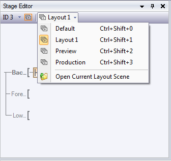

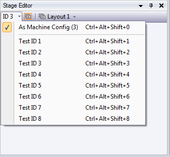

Inside the Stage Editor one can switch the Layout to be used by the current project (see below) as well as temporarily change the !MachineID for the local machine in order to test cluster setups. Both features are also accessible via keyboard shortcuts.

A Layout is a scene loaded by the project in front of the first 'user-scene' on Level 1. Layouts are placed on Level 0 and can be used to create complex scene setups like multi-screen, stereoscopy, cube-projections, layering, etc. The big advantage of using Layouts is that one does need to modify the scene to switch to a different setup. E.g. the switch between a Design (used to build a scene) and Production (used to present the final result) setup in a 3-Projector-Shaping project just requires the change of the Layout in the Stage Editor.

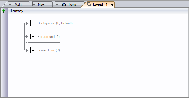

Layouts are usually very simple scenes holding at least one unlocked Scene Port, preferably Port Ordinal 0 (the default port) is not locked. A Layout scene is a normal scene: one can use all nodes, externalize properties and insert layout related content. The possibilities of Layouts are numerous:
Layout scenes opened in the Designer via Stage Editor are marked with a special icon in the scene tab!

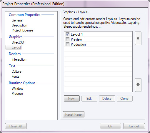

The configuration of Layouts is done in the Project Properties. The Layout section in the Project Properties dialog provides possibilities to create and edit Layouts.

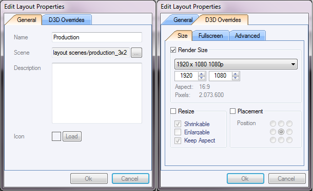

A Layout setup is created by clicking the New button. In the General tab, a name for the Layout and the actual Layout scene file can be chosen. The fields Description and Icon can be used to help other users who work on the same project.
Every entry in the Layout list has a prepended check-box. The checked Layout is selected as the Runtime Layout which is automatically used if a scene is exported as Presentation (VPR) or the Ventuz Runtime is started in Director mode.
A very important feature of Layouts is the possibility to override the actual rendering and screen settings of the actual Ventuz project. In the D3D Overrides tab, a small check-box on every configuration group can be checked to specify new values for each particular Layout.
