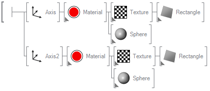

If CTRL + SHIFT are pressed, a link (in some programs also called a reference) to the existing nodes will be inserted instead of a duplicate. This is a very powerful but also potentially error-prone and complex feature when working with tree structures. It is powerful in that the same nodes can be used multiple times in a scene although only one copy resides in memory. The problem with multiple linking is that the linked nodes appear at multiple positions in the Hierarchy Editor but the user still has to keep in mind that there is in fact only one instance. Any change done to the one item in the tree will also affect the other because there is only one node. Similarly, deletion of linked nodes can create unintendend or unforseen consequences when linked references are forgotten about. Nodes that have multiple links are designated with a gray triangle in the lower left corner of the node icon, see here.
In the example above, there are two axis nodes but only one material node. The material node has been linked to each of the Axis nodes.

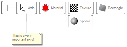

When coloring is not enough, the user can also add a "note" to a node by selecting the node and then choosing Menu/Node/Edit Annotation or from the context menu (pressing and holding the right mouse button until the menu appears). The box can contain any HTML formatted text, thus being the ideal place to leave notes (i.e. keyboard shortcuts, ...) to the person that will actually run the show or to a colleague also working on the same scene.
The visibility of annotations can be toggled with CTRL + SHIFT + A.
