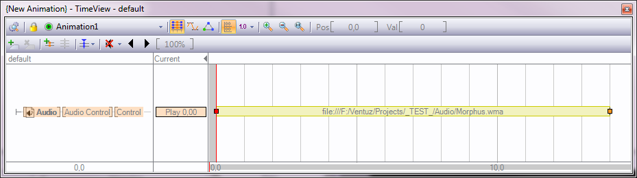

The category Audio Control provides properties to start, pause and continue the audio playback. The property Control can be bound to a Keyframe Animation node to control the playback in the time-line of the Animation Editor.
