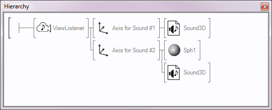

To create such effects the combination of two Nodes is necessary. The SoundSource 3D node represents the position, velocity and orientation of the sound source. The ViewListener node represents the position, velocity and orientation of the listener.
The SoundSource 3D Node represents a sound source which can be positioned in 3D space using a regular Axis node. This node comes with a multitude of input properties to control the 3D sound effect.

The ViewListener node is a combination of the View node and a listener in 3D space. It’s the eye and ear within a Ventuz scene. The positioning of the ViewListener is done by a matrix which is bound to the property View. This matrix comes either from one of the Camera nodes or the Matrix nodes.
