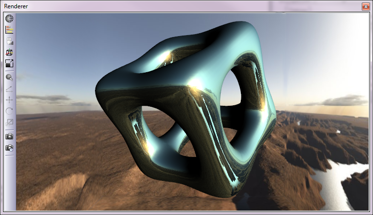

This node takes six images as inputs and creates a cube texture which is need for environmental texture mapping. For example the SimpleReflection shader needs such a texture to work at all. The six images have to represent the view of the six base directions from the center of the object on which the cube texture should be applied. E.g. ImagesPosX must be the image of the view in the positive X direction. The property Size defines the edge length of the resulting texture cube.
