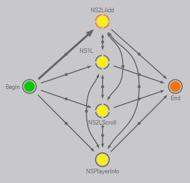

Let's take a look at what really happens in the Ventuz Runtime when the operator cues a template from Director:
  1. Unless it is already in memory, the scene file the template is part of is loaded.
  2. The template engine tries to find a route from the current template to the cued template using the transitions defined in the animation state logic.
    1. If both templates are part of different scenes or different animation nodes inside the same scene, the task is split into two: Find a route from current to any End state and then find a route from any Begin state to the cued template.
    2. If both templates are part of the same animation node, a direct route is searched for. If none exists, the task is again split into two routes via Begin/End states as in the previous case.
    3. If no route to a Begin/End state exists, a jump to that state is performed instead.
  3. Once the operator performs a take, the calculated route is used to play the transitions that lie on the route.
  4. The template engine stops at any non-begin/end state on the route and will require the user to perform another take, resulting in a so called multi-take template.
Note that each transition can be valid in only one of its two directions or both at the same time. For example, there is a transition from NS2LAdd to NS1L that works in both directions. If one is currently active and then replaced by the other, that special transition is used instead of going to End and then starting at Begin again. On the other hand, the template engine cannot go from NS2LAdd to NS2LScroll via Begin as the transition from NS2LAdd to Begin is not valid in that direction. The direction of a transition can be changed by selecting a transition and pressing R.
The R-key will have no effect and no arrow heads will be drawn on transitions unless the animation is part of the Scene Data.
If there are multiple possible routes, the Template Engine always chooses the shortest route possible based on the number of transitions that have to be traveled along. The actual duration of a transition is not part of this criteria.

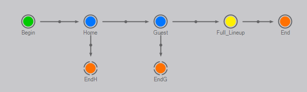

As mentioned in the Routing section, Templates can be designed to have multiple takes. To achieve that, add States of the type Normal on the route to the Present State. Each of these represents one take.
Assuming a line-up for a team sports match should be designed. At the first take the home team should be shown, at the second take the guest team and at the third take both teams at once. The according State Logic could look like this:
Adding additional End States to the State Logic gives the possibility to add animation paths to take the Template off air with a defined animation from any State.

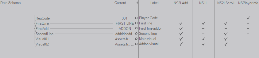

To add some form of data to a template, switch to the Data View inside the Animation Editor. Similar to Animation Channels, any property can be made accessible by a template by simply dragging it from the Property Editor to the Data View which will create a new Data Channel. Also, a yellow dot appears next to the property to visualize this is now bound to the Animation Data of some Keyframe Animation node.
Since there is one set of data channels for all states in an animation, data needs to be associated with the specific states for which they make sense. For example, if one state shows only one line of text and another has another line of text for a sub-title, the sub-title should not appear as a data entry field inside Director when the first template is cued. This is done by setting/removing check marks in a states column inside the Data View. In the image above, the ReqCode data channel is for exampled only valid for the NSPlayerInfo state/template.

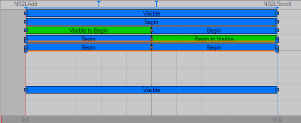

If two templates share the same data channel and there is a crucial point in the transition between them. Imagine the first template currently being active, the operator cues the second template and then changes the value in the common data field. What happens when the operator does a take? At which time does the data channel switch from the old to its new value?
The default behavior is that the new value is immediately applied which might or might not be what the designer intended to happen. Usually the designer wants to fade out a text label showing a headline before it fades in with the new text instead of the text suddenly changing. So there is an amount of time on the transition where the old value should remain before the new one is applied. That value can be defined by one or more transition points along a transition curve by pressing M instead the Time View.
When a transition is performed, the Template Engine checks if there are any transition points:
So why should there be more than one transition point along a transition? Because the transition might be valid in both directions (see the section on Rounting) and the point of update might not be the same. Especially if the update requires resources (e.g. images) to be loaded, it should be triggered as soon as possible such that the data uses the time before the animation actually makes the new values visible to the user. For example, the new image might already start loading while the current image is still fading out.

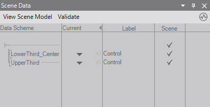

Another way to test transitions is via the Scene Data Editor. Click on the downward pointing triangle in the Current column that is next to any controlled keyframe animation. A list of present and end states appears and left mouse button clicking on any of them will again perform one step of the route towards that state.
The context menu will only appear if the scene's data model is valid. Make sure there is no error sign visible in the toolbar of the Scene Data Editor.
