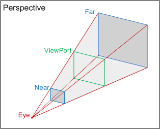

Perspective creates a perspective pixel based projection where the Frustum is defined by the actual size of the current ViewPort (screen size) and the value specified in Eye. The Eye position must be lower than the the near plane position! A Rectangle will be pixel perfect if it has a Z-position of zero. Perspective shortening will occur when translating the object or rotating it away from the X/Y-plane.
