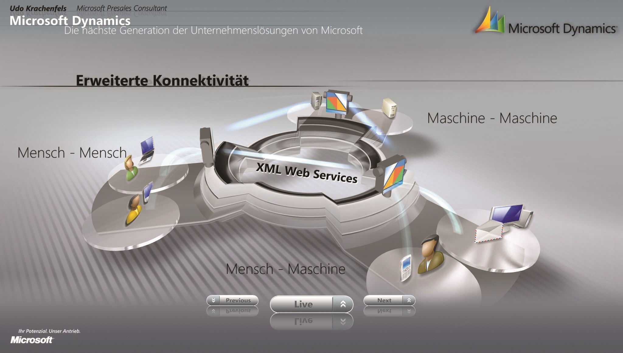

In the example shown here, a slightly different setup has been used. A directional light comes hard from the right, a point light sits above the scene and a spot light comes from the top right corner. You will notice that although only the standard Ventuz materials are used, the shading on the objects is much more interesting than what only the Head Light would produce.
The example above also contains a weak reflection on the ground. It was created with a mirror reflection technique as described in the How To Add a Mirror Reflection how-to. While the applications of mirror reflections are limited, having a reflective ground has been a standard design element of many product presentations for years now.
