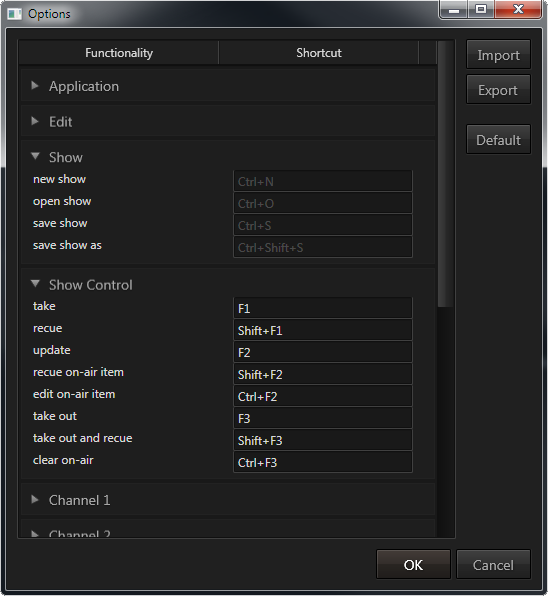

Starting with Ventuz Director V4.05, keyboard shortcuts can be customized by the user. The short cut manager can be found in the main menu under Tools / Shortcuts. The shortcut layout is stored in the user settings on a machine. To transfer a layout to other users and/or machines, use the export and import buttons.
The list below shows the most important default keyboard shortcuts. To reset a shortcut layout, use the "default" button.
