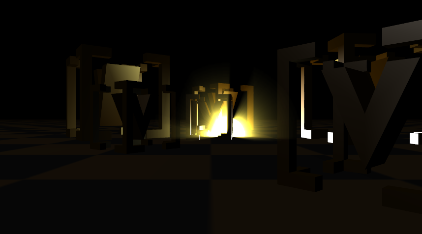

A "God Ray" shader is a classic image space post processing shader. It mimics the light streaks emanating from a bright light source when it is surrounded by a participating medium such as mist. The shader - from a top-level perspective - consists of two elements: A geometry that represents the light source as well as a number of occluders that can block the light of sight towards the light source.
Algorithm
The basic algorithm is rather simple: First, render the part of the light source geometry that is not occluded, then blur it from the center of the light source outwards to produce the characteristic light streaks. All this is done in 2D image space instead of the 3D world as computing how the light rays propagate in the medium would be way to expensive for realtime rendering. So the goal is to look cool, not be physically correct!

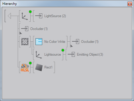

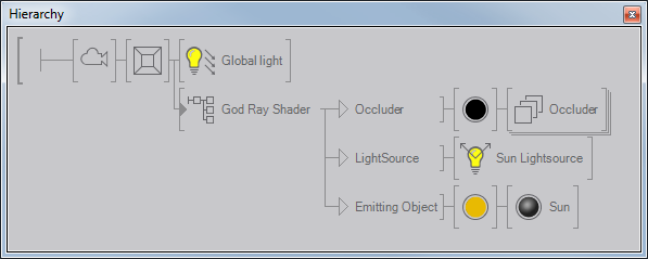

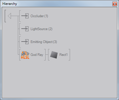

Now we need to create the setup to use the shader correctly. The main task will be to create that input texture which contains the masked light source geometry. Let's start by putting the HLSL node into a Hierarchy Container. Rename the existing Output to "Occluder" and add two additional ones: "Lightsource" and "Emitting Object". We also add the aforementioned Rectangle behind the HLSL shader node.
Let's step out of the Container for a moment. We will use the Occluder output for all parts of the scene that should occlude the lightsource. At the Lightsource output, we'll add a Point Light. This is not strictly necessary, but the shader will just create the streaks, the other geometries in the scene will not be shaded by our shader. So we add a true light source at this output and move consistently with the lightsource geometry we will use to create the god ray effect. Speaking of which, at the Emitting Object output we'll add a Sphere and put a Color node in front of it. Set that to a nice yellow color.
Masked Light Source
Back inside the container. Add a Render Target above the HLSL node. We need to render the light source geometry but masked by the occluders, a typical job for a stencil mask. However, we'll do something differently here: We use the Z-Buffer instead. Behind the Render Target add a Render Options node and place the occluder output behind it. Deactivate the RGBA channels for Color Write (if you don't see those properties, you might have to select the Render Options node in the Content Editor). In a second branch behind the Render Target, add an Axis and put the Emitting Object output behind it.

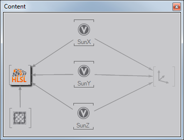

The Axis is supposed to give the user the capability to move the light source from outside the container. We will need the position in the HLSL shader node as well, so add three Float Variable nodes, label them X, Y, Z and expose their properties. Connect the outputs of those variables with the position properties of the Axis.
Finally, bind the Render Target output to the Texture parameter on our HLSL shader node.
The Lightsource
This renders the God Ray light streaks, but not the Lightsource or the Occluders. So add an axis above the Render Target. Move the Lightsource output behind the axis and connect the Axis' position properties to our three floating variables. Now select the Occluder output and press Ctrl+Shift while dragging the Output below the Axis. This will create a node reference.
Summary
So from the top:
  1. Render the Lightsource translated by the exposed X,Y,Z position values
  2. Render the Occluder. This is the normal rendering of your scene.
  3. Activate the Render Target. First render the Occluder just to the Z-Buffer and then render the translated Emitting Object in the usual way.
  4. Activate the HLSL shader and render the Rectangle.
