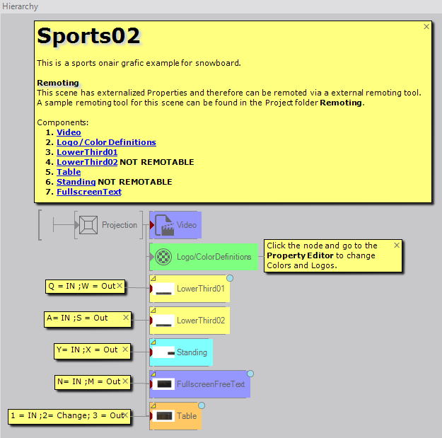

First, let's have a look at the existing scene. Open the project and load the scene Sports02_CustomVideo. It provides examples for on-air graphics for a sports event. Looking at the Hierarchy Editor from top to bottom we find the following components:
We will ignore the VideoContainer because this is for demo purposes.
Since Logo/ColorDefinitions defines virtually project wide global properties, this job can perfectly be handled by Project Data.
The other components all contain graphics we wanna show on screen. So we will refactor them to become Templates. Let's have a closer look: !LowerThird01 and !LowerThird02 appear at the bottom of the screen. Standing appears at the top, FullscreenFreeText and Table need most of the screen. We see that Standing and one of the Lower Thirds could be on screen at the same time, while the other ones need to appear exclusive. We take care of that in our design.

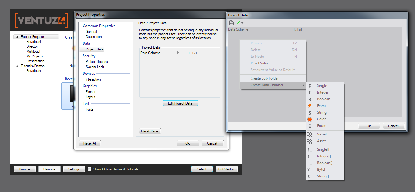

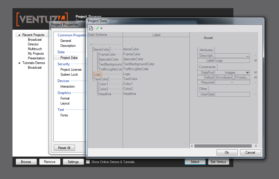

Let's start the actual refactoring. We start with replacing the Logo/ColorDefinitions Container by Project Data. For that, we need to create channels for our Project Data in the Project Properties. In the menu go to File -> Change Project. The project closes and the Project Browser appears. right mouse button click on your project and select Properties. In the Project Properties dialog, go to Project Data and left mouse button click Edit Project Data. right mouse button click on the small root symbol and under Create Data Channel select the desired type.

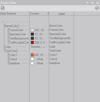

Logo/ColorDefinitions holds seven colors and one logo. So for the colors create data channels of type Color. For the logo choose Asset. Give all channels a proper name and label, and choose default values. For Logo set the DataPool to Images and set the default to ventuz://images/Snowboard_01/ventuz_logo_alpha.tif to have the same logo as used before.
You can create Subchannels to clear the appearance a bit. The result should look like this:
Finish the dialog and load your project again. Press SHIFT+F12 to open the Project Data Window and have a look at the created channels.
This Project Data replaces our Logo/ColorDefinitions Container - which now we don't need anymore - and every Property that was bound to it will be bound to the Project Data later. Go to the Hierarchy Container and delete the Logo/ColorDefinitions Container.

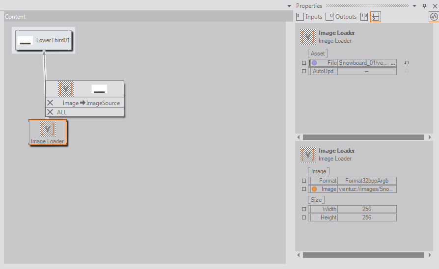

Binding the logo needs some extra attention. The !LowerThird01 Container has been designed to receive an image, so we can not bind it directly to our Project Data. Instead take an Image Loader and bind the File Property to the Project Data Channel called Logo. Then bind the outputted image of the image loader to the according input of !LowerThird01.

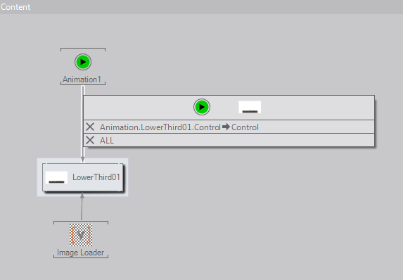

Now we take care of the animation. To make things easy, we leave the animation inside the container untouched and use the mechanism of Nested Animations. This means another animation controls the animation inside the container. Therefor we need to expose the Control property of the original animation. Do that by moving into the !LowerThird01 Container, select the animation called Insert01_MainAvi from the Content Editor and click on the small box next to the property called Control. The box should turn green. Now move out of the container, add a new Keyframe Animation node to the Content Editor and bind the newly exposed Control property of the !LowerThird01 Container to this node.

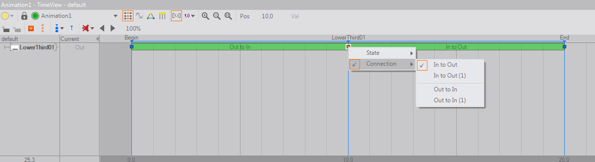

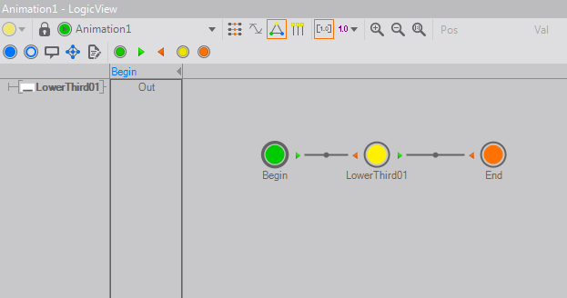

Go to the Logic View of the new animation and add three states, one of them being a Present State. Then move to the Time View and set up the animation so it looks right, respectively as in the original scene.
Next open the Scene Data Window by pressing F12 and bind the Control property of our new animation to the Scene Data. Do that by selecting the Animation node, left mouse button click and hold the Control Property and drag it to the Scene Data Window. left mouse button release when the label turns green. If done correctly, the icon of the animation node turns yellow and the Control property is decorated with a light blue dot.

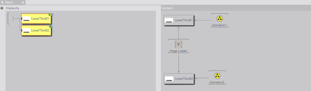

Now add the second LowerThird to your scene. Since !LowerThird02 is very similar to !LowerThird01 just repeat the steps above to add !LowerThird02 to your scene.

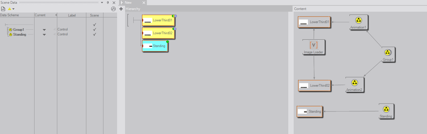

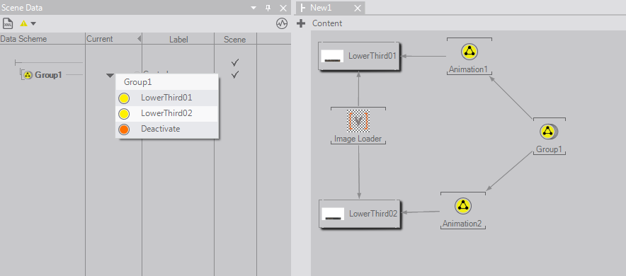

If you do it as in the screenshot above, you can put both Lower Thirds on air at the same time and they will overlap. In Step 1 we found out that we do not want this to happen. So what we do is make them exclusive by using an Animation Group Node.
Go to the Scene Data Editor and delete the two animation data channels by right mouse button click and choose Delete from the context menu. Now add an Animation Group Node to the scene and bind the Control properties of the two animations to it. Lastly add the Control property of the Animation Group to the Scene Data. Have a look at the Scene Data Editor. Now one of the two Lower Thirds can be chosen, but not both at the same time.

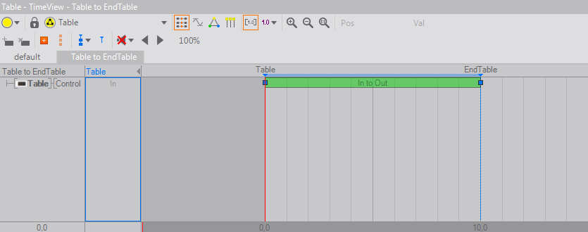

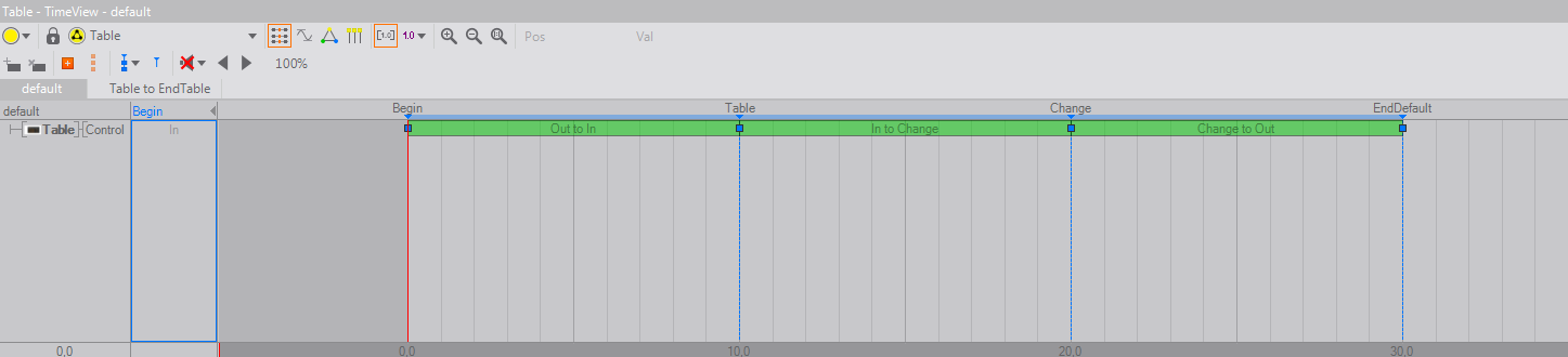

Copy the Table to a new scene and follow the same steps as with the other graphic elements. What is different is the animation logic. Instead of adding a begin, a present and a end state, add a state of the type normal and another end state as shown in the screenshot.
Adding states on the way to the present state leads to a so called Multi-take Template. The path from the normal state called Table to the state called EndTable is for taking the Table off air with a proper animation when not doing all takes of the Template. Of course this path needs to be animated in the Time View like any other. The screenshot shows the different slices.
