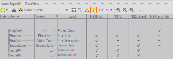

DataModel
A DataModel defines the structure, names and types of the data required for the hosted templates. Every template within a host selects a subset of one of these data models. This subset could be empty or the entire data model. Every Template Host defines zero, one or multiple DataModels. A template host defines its default DataModel where grouped animations do not have a default DataModel.
The data model can be created and accessed via the Data View of the animation editor window. As we saw above, this is also where Subtemplates are added and controlled.
To add a data item, simply drag and drop the property to be controlled as animation data into the animation data panel. It will be added in a similar fashion to a scene data or project data element, except that each data element can be associated or disassociated with any of the templates of that animation node. The data panel lists all of the data items for the templates in an animation node and a column layout allowing for every item to be checked or unchecked for each template. By checking the item, the data will be associated with that template. Thus it is possible to have quite complex data models where some data items are shared between templates and others are not.

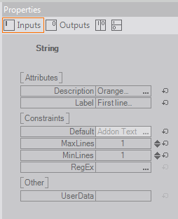

Each element should be given a unique name, and by clicking on it, you can also edit, in the properties panel, settings such as default value, allowable minimum and maximum values, a label for operator identification, or a description. Remember that as soon as you set up a data channel, any local value you had set will be overridden by the animation data, so it is worth setting up a default value first.

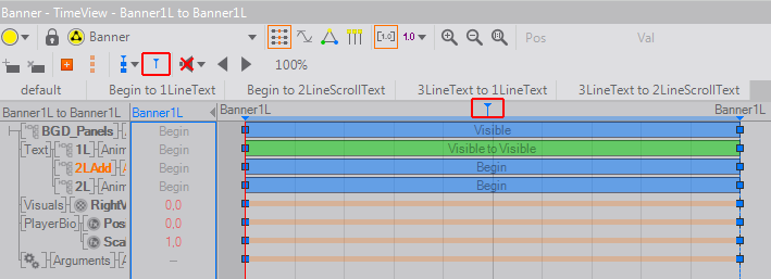

An important key to transitions is the exact point when this data, associated with a template, is passed to the animation node. So, for example, if a self-to-self transition is called, but the data changes, perhaps an animation is desired where the data is changed at a specific moment, but the actual template changes very little. The exact transfer point for the data can be defined in the timeline by positioning a data marker. To place this marker, enter the animation editor window and position the timeline at the point where the data should be transferred, then press M. It will add a small marker at the top of the animation timeline. This marker can be moved, as its properties edited by dragging or selecting it. Multiple markers are allowable, in which case data will be updated on the first marker that is passed and subsequent markers ignored unless the data has changed.

Attributes of DataItems
Name C# Type Description
Name string Defines the technical name of the DataItem
Label string Contains the label text how the DataItem should be presented to the user.
Description string Contains a short description of the DataItem
Required bool Defines if a sub-template must be assigned (true) or not (false)
Default item type Default value of the DataItem
Min/Max item type Minimum and maximum value of the DataItem
Speed item type Edit speed of the DataItem
Min/MaxLines uint Minimum and maximum number of text lines for the DataItem
Elements string[] List of valid elements to fill the DataItem
Alpha bool True if the color requires the alpha component
AssetPools AssetPool Asset pools of the DataItem
Min/MaxLength uint Minimum and maximum number of elements in the array
UserData string A user-defined general purpose string.
