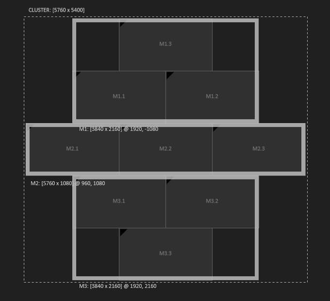

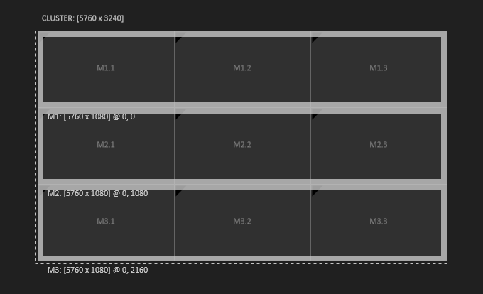

The goal of this section is to setup a cluster wall of 9 displays arranged as a rhombus. The cluster should consist of three machines with three outputs each. We will assume for this example that the displays are bezelless. Each display has a resolution of 1920 x 1080. The final wall with Ventuz content on it could look like this:
First of all you have to create the appropriate Render Setup configuration. Open the Ventuz Configuration Editor and select the participating machines.
If the machines for the cluster are already available in the network, it is important that they use the same non-zero Group ID and each machine has an ID starting from 1 for the first machine, 2 for the seconds, etc. If the machines uses multiple outputs you have to configure the graphics driver to treat them as one logical output. NVIDIA calls this Mosaic technology, AMD calls it Eyefinity. Log onto those machines and use the appropriate tools of the graphics vendor (e.g. NVIDIA Control Panel or AMD Catalyst Control Center).
After the machines have been pre-configured correctly, select the group in the Machine Selector and add a new Render Setup by clicking the Plus button. Choose a sensible name and click OK. This will open the Render Setup Editor with the display configuration of the connected machine or group of machines which is currently active in the Graphics Driver. The initial Render Setup we need is a 3x3 display wall with three machines of 3x1 displays.
If you want to create a Setup without being connected to the real cluster machine, launch the Create New Setup dialog and select the Advanced tab. Displays Total must be set to 3x3; fill in the correct resolution and increase the Num. of Machines to three! Make sure that Displays per Machine is set to 3x1 (an arrangement of 1x3 would be possible but would not give the optimal result).
The display position of the upper and lower machine have to be modified to get the required arrangement. Do not forget to save the final result!

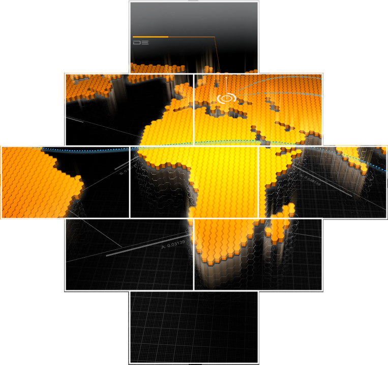

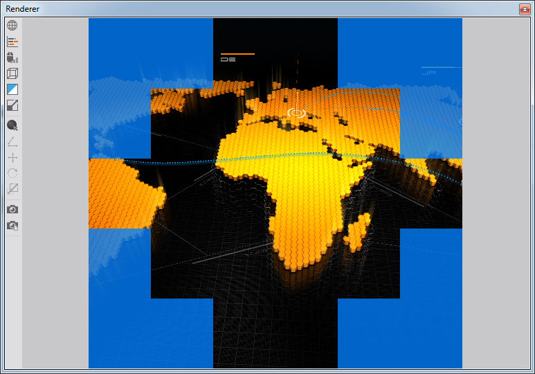

The scene from the wall will look as follows in the Renderer window of Ventuz Designer. As Ventuz can only render rectangular areas it applies a mask in the preview modes (Cluster and Machine Preview) to mark the render content which will not be visible in the final Production Mode when running in the Ventuz Runtime.

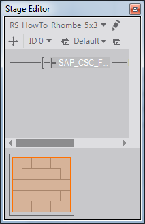

There are three different rendering modes for Render Setup rendering available:
The last two modes are pretty handy if you want to see whether your scene is well prepared for a multi-machine rendering or not.
The rendering mode can be changed in the Stage Editor by clicking on the display arrangement preview at the bottom of the Stage Editor. Click on a single highlighted machine or the border of the whole cluster to switch between Machine and Cluster Preview. To switch to Production mode use SHIFT -
click.
As the rendering mode is linked to the Machine ID it can also be changed in the ID drop-down box of the Stage Editor.

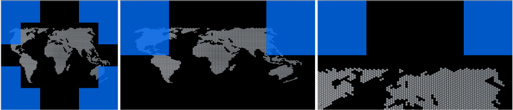

First of all we take a look at the Overlay node and how it behaves with different ScreenAligned settings in this Render Setup configuration. A simple scene containing only a Texture in front of a Overlay Rectangle will demonstrate the differences.
The left image show the full Cluster preview with one texture over all displays. The image in the middle shows the preview of the upper machine with disabled ScreenAligned mode of the Overlay node. The complete texture is visible over the whole machine output. This does NOT match with the upper machine content in the Cluster preview. The right image show the machine with enabled ScreenAligned property. In this case the machine only displays the part of the texture according to the Render Setup configuration.
In other words: the Overlay node in ScreenAligned mode performs a per-machine segmentation of cluster-wide textures. If you already have pre-segmented machine-individual textures then the ScreenAligned property must be disabled.

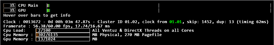

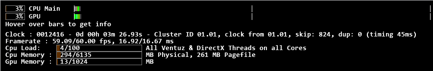

When activating the statistics in your render window, you will notice some additional information:
Cluster ID 01.02 means that this machine has the Group-ID 01 and the Machine-ID 02, the following number shows the current value of the cluster clock, and the clock from 01.01 indicates that the current clock master has Machine-ID 01.
On a slave system the type of the cluster clock is colored green, on a master system it is white.
A font color change on a slave system from green to white indicates that the slave has lost its master clock and is running independently. Make sure that your slave systems show a constant green writing without any flickering between green and white.

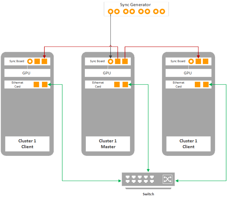

To synchronise your cluster outputs, install a synchronization board to every machine in your cluster, following the manufacturers instructions.
Go on with connecting the boards. Every sync board has one BNC connector for an external timing source and two RJ-45 connectors to connect the sync boards among each other. Be aware that the RJ-45 are only for connection between the sync boards. Do not connect them to a usual Ethernet as this can cause damage to the boards.
So have a look at the image below. The connection between the sync board is independent from the Ethernet connection.

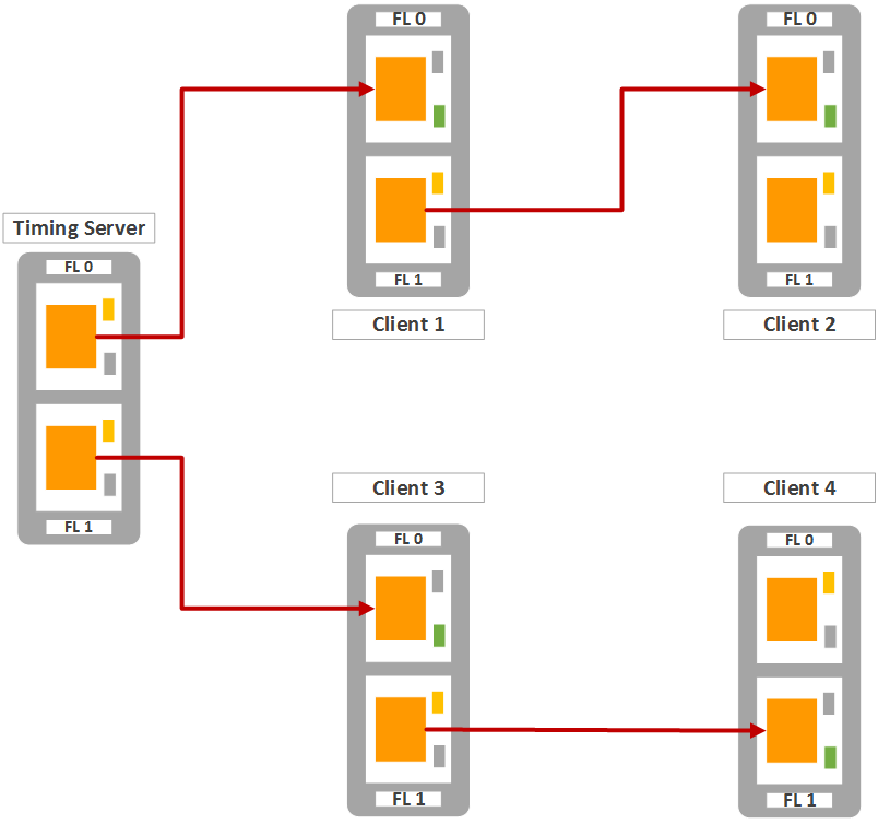

To synchronize the cluster, one machine acts as the timing server, the others as clients. For Framelock applications, the timing server uses an internal signal as timing source. For Genlock applications, connect an external timing source, e.g. the house sync, to the timing server via the BNC connector as seen in the image above.
The machine that acts as the timing server uses both of its RJ-45 as outputs to distribute the timing signal. A client uses one as input and the other one as output, so the signal can be passed to another client. It is recommended to split the clients in two equal groups and arrange each group as a daisy chain connected to one of the two timing server outputs.

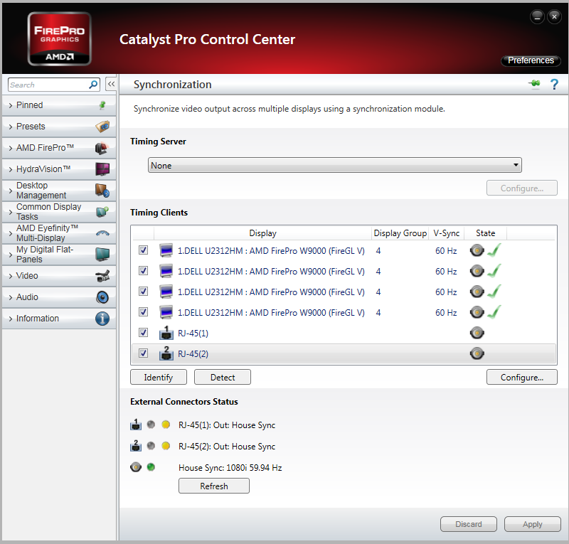

Next, configure the timing master and client in the graphics card driver. See your graphics card manual for details. Below is an example screenshot for a four display machine set up as timing master. Configured in AMD Catalyst Control Center. The timing signal comes from an external sync generator.
For detailed information on how to set up the synchronisation boards, refer to the manufacturers documentation.

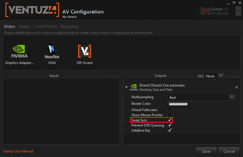

So far we aligned the displays refresh rates to a common time source, be it internal or external, to avoid tearing or flickering. This was done in the graphics card configuration. As described above, Swap Sync requires support by the application - Ventuz in this case.
To enable swap sync, move to the DirectX Output of the AV Configuration.
Be aware that Swap Sync only makes sense and only works if the synchronisation boards are configured correctly.
Note that Swap Sync only works in exclusive fullscreen mode!
