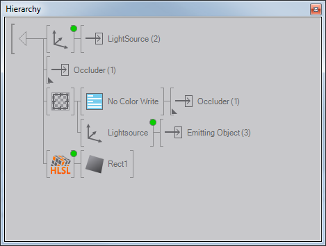

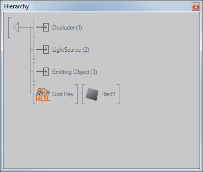

Now we need to create the setup to use the shader correctly. The main task will be to create that input texture which contains the masked light source geometry. Let's start by putting the HLSL node into a Hierarchy Container. Rename the existing Output to "Occluder" and add two additional ones: "Lightsource" and "Emitting Object". We also add the aforementioned Rectangle behind the HLSL shader node.

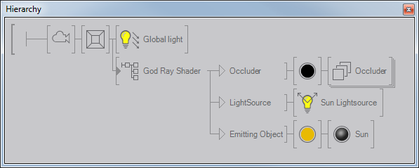

Let's step out of the Container for a moment. We will use the Occluder output for all parts of the scene that should occlude the lightsource. At the Lightsource output, we'll add a Point Light. This is not strictly necessary, but the shader will just create the streaks, the other geometries in the scene will not be shaded by our shader. So we add a true light source at this output and move consistently with the lightsource geometry we will use to create the god ray effect. Speaking of which, at the Emitting Object output we'll add a Sphere and put a Color node in front of it. Set that to a nice yellow color.
Back inside the container. Add a Render Target above the HLSL node. We need to render the light source geometry but masked by the occluders, a typical job for a stencil mask. However, we'll do something differently here: We use the Z-Buffer instead. Behind the Render Target add a Render Options node and place the occluder output behind it. Deactivate the RGBA channels for Color Write (if you don't see those properties, you might have to select the Render Options node in the Content Editor). In a second branch behind the Render Target, add an Axis and put the Emitting Object output behind it.

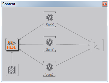

The Axis is supposed to give the user the capability to move the light source from outside the container. We will need the position in the HLSL shader node as well, so add three Float Variable nodes, label them X, Y, Z and expose their properties. Connect the outputs of those variables with the position properties of the Axis.
Finally, bind the Render Target output to the Texture parameter on our HLSL shader node.
This renders the God Ray light streaks, but not the Lightsource or the Occluders. So add an axis above the Render Target. Move the Lightsource output behind the axis and connect the Axis' position properties to our three floating variables. Now select the Occluder output and press Ctrl+Shift while dragging the Output below the Axis. This will create a node reference.

All that is left for you is to expose the right values to the outside of the container. We'll want to have:

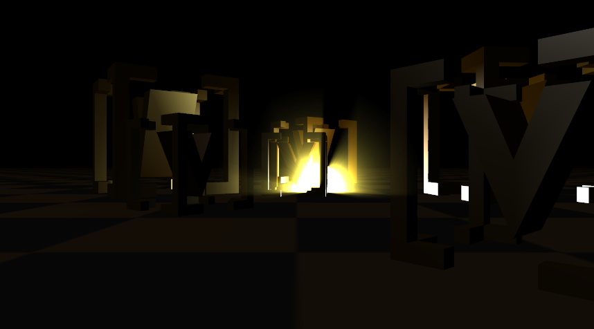

After all that work, we now have a nice and easy to use God Ray shader. For debugging purposes, it's nice to add additional techniques inside the shader. For this shader, two techniques are quite handy:
It is usually best to do such "alternatives" as additional techniques. Some people rather use boolean parameters, but those actually extend the vertex/pixel shader programs and thus make the shader slower. We won't be going into details on how to implement those techniques but both amount to knocking out a few lines of code or overwriting an alpha value here and there.
Wow, that was quite a bit. As you can see, converting the actual shader code was quite straight forward. The part that most shader tutorials/books unfortunately leave out is providing the infrastructure for the shader to actually work. However, with some practice, there are a lot of re-occuring patterns. For example, using a Rectangle to produce a screen filling output is a technique common to a lot of shaders.
