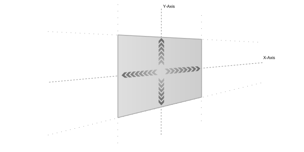

Touch Translation
Use for: Sliders, 2D positioning...
A single touch is used to translate the object in x/y direction. This is usually used with the X- and Y-axis aligned to the screen but rotated version are also possible in order to move objects back and forth in 3D space.
Be careful to have the vanishing points of both axes lie outside the area visible by the camera as mapping calculation close to those points is error prone.
A simple slider can be built by using the Limit input properties to restrict movement in one direction.

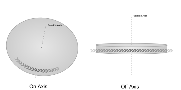

Touch Rotation
Use for: Slot machine style wheels, volume knob style elements, stearing wheel, ...
The most important properties for Touch Rotation are the Rotation Axis and the Mapping mode. The on-axis mapping mode assumes that the user roughly looks along the rotation axis onto the top of the object (i.e. a steering wheel or the dial plate on an antique telephone). In this mode, the node will try to follow the touch as closely as possible in order to keep the same point on the surface under the touch position at all times. This makes it possible to do very precise rotations even up to the point where one can do a complete revolution. However, this mode can feel weird if the touch changes its distance from the rotation axis.
The off-axis mapping mode assumes that the rotation axis is at roughly a 90 degree angle to the viewing direction (i.e. a slot machine). When rotating, the object will only stick to the touch position up to a certain point. As the touch gets closer to the boundary of the object, a different mapping is used so that moving the touch further along will keep the object rotating at a constant speed. While one looses the feeling of the object sticking exactly to the finger, this mode feels much nicer when it comes to making an object spin.
Both modes work completely different and which one is more suitable depends on the specific case of usage.

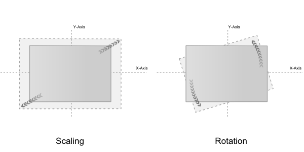

Touch Transformation
Use for: Moving picture metaphor, scaling objects, ...
The Touch Transformation node combines the most common one and two finger gestures to interact with an object. A single touch can be used to translate an object. Two touches can be used to rotate the object (by doing a circular motion), scale it (pinch/stretch), and translate it (by moving all touches in the same direction).
Due to the degree of freedom with this node, there are only few practical use cases for it. Typically, a user will use the Limit properties to restrict movement in one or the other direction. In most cases however, one should try to avoid the use of the Transformation node in favor of the dedicated Translation or Rotation node.

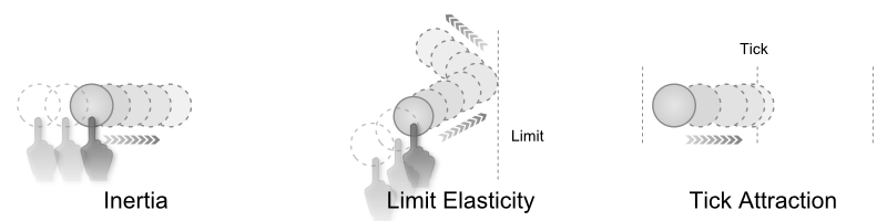

Physics Simulation
All transformation nodes contain a simplified physics model to simulate effects like inertia or other post-motion. Subtle effects like these are crucial to convey realism or "weight" in a MultiTouch scene.
As stated before, the physics model inside Ventuz is a simplified one custom tailored for MultiTouch purposes. It is not designed to handle collisions, gravity or other factors expected in a full-fledged physics simulation.

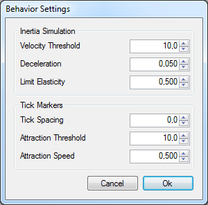

The physics simulation is by default enabled for all Touch Transformation Nodes. To disable it, uncheck the BehaviorApply property. This is independent of whether or not the object will move (see BehaviorMotion) and just prevents the physics simulation of influencing the values generated by the mapping calculation.
To modify the physics properties of a node, click the Edit Behavior button at the bottom of the Property Editor.
There are three forces that can be applied to the object moved by any of the transformation nodes:
All these parameters are based on the nodes own mapping system instead of real world parameters like screen distance in cm. While this is often unintuitive, it is the only plausible solution to be both screen size independent and capable of handling motion that is not aligned with the screen plane.
The Machine Configuration has two options to adapt physics behavior parameter to changing screen size. As long as Scale Thresholds with Window Size is active, Ventuz will do its best to internally scale all parameters such that the user experience stays the same. For more explicit measures, an additional scaling factor that is applied to all parameters expect tick spacing has been created.
