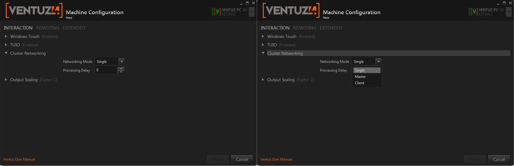

By introducing this serialization into atoms and dispatching of the collected information, Ventuz is capable of distributing input information from one machine to a whole cluster without any additional logic in the scene. Where in previous versions it was the responsibility of the author to translate input information to OSC messages to get them from one machine to another, it now is as easy as setting the right option in the Machine Configuration.
Open the Machine Configuration under Menu/Tools/Machine Configuration and then go to Interaction/ClusterNetworking.
If Single Machine Setup is selected, the event atoms will directly be handed over from the hardware devices to the virtual devices and no network traffic is involved. When a Ventuz scene is running on a cluster of machines, all input devices that are used in the scene should be connected to one machine, the Master. Selecting master in the configuration will cause this machine to serialize the atoms to network packages instead of passing them to the virtual devices by memory. All Client machines on the other hand will ignore all hardware input devices connected to them in the sense that their input will not be received by the respective Ventuz nodes. Instead, they open a network port and list to information coming from the Master machine.
The input information will be broadcasted to the network on a dedicated ip and port. Make sure routing and firewall settings do not prevent those packages to reach the clients.
All machines in the cluster, including the Master, will only send input information to the scene nodes that has been received over the network connection. In case network latencies prevent the information to be received in the same frame, the option to add a Processing Delay has been implemented. If an input event has been broadcasted in frame N and the processing delay is 3, the input event will be cached until frame N+3 is being rendered.
To synchronize input processing in cluster mode, processing is done based on the internal Cluster Clock. Make sure Ventuz is running in Cluster-Mode.
