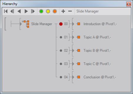

The Slide Manager node basically acts like a switch, controlling which of its child slides will be shown. As soon as a SlideManager node is added to the scene, the Slide Manager Toolbar is displayed at the top of the Hierarchy Editor.
The first set of buttons is used to reset and navigate through the presentation. The set of green, yellow and red buttons makes the current slide jump to one of three states which will be described later on. The plus and minus signs are for increasing and decreasing the number of slides. Finally, the name assigned to the Slide Manager node is shown on the right.
By default, the Slide Manager node listens for the left mouse button and certain keyboard keys. This can lead to problems when using Interaction Nodes or other input nodes that listen to the same events. In such a case, make sure to deactivate the InputsEnabled property and see the section Controlling a Slide Show later in this document.
The Slide Manager node itself consists of a Hierarchy Container which is used to host all the nodes belonging to the background, an output for each slide and a Slide node automatically added to each output.
A red circle before the output number indicates the current active Slide. If the circle is green, the Slide is being rendered. If gray, the Slide is completely blocked.
