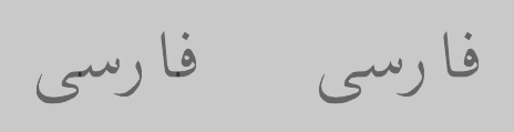

A common problem arises with transparency and script fonts like Arabic. Where the letters touch, the two layers overlap and the region is too opaque.
For the plain layer, this problem can be resolved using the ImproveTransparency property. This needs the stencil buffer. So if you are using the stencil buffer, you need to clear it before using this property, and assume the stencil for the whole screen to be lost.
It will only work on the plain layer, and requires the High Quality 2D Text Rendering to be disabled in the machine config.
Example: Text displayed with alpha at 50%. Left without ImproveTransarency, right it's enabled.

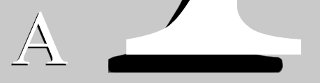

Example Left: White plain layer with black drop-shadow using effect layer in plain mode. Right: the same at 1000 pixel size. See how the plain layer looks perfect while the effect layer shows artifacts. Still, the effect layer looks way better than ordinary texture fonts.

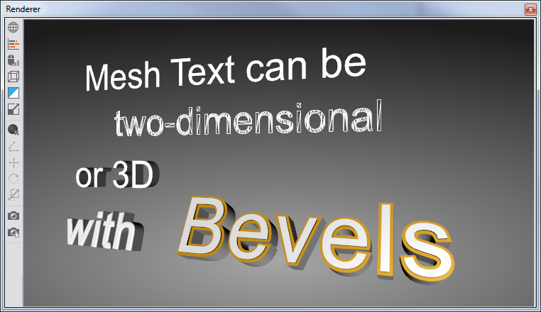

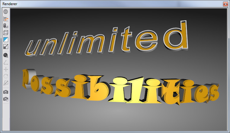

Text 3D is a Hierarchy Node and is used to render two- and three-dimensional text. The characters displayed by this node are actual geometry consisting of triangles that form the shape of the character.
Like any other geometry, Text 3D can be used in combination with textures and shaders, regardless of the text being 2D or 3D. Bevels can be added to extruded mesh text to either soften the corners of the text or to create new designs. The individual parts of an extruded and beveled mesh font, such as front and back face, the extruded hull and the bevel itself can be individually controlled and combined in order to create custom styles and designs.
The mesh for every character comes from a set of pre-generated meshes. These meshes contain all (or subsets of) characters included in the selected font. The font meshes are generated and saved in the Ventuz Program Data folder. This happens when a font is used for the first time. If the same font is used again, it only must be loaded into memory. The generation of the complete Arial font, with about 1400 characters, can take 5 – 10 seconds. This depends on the hardware of your computer system.

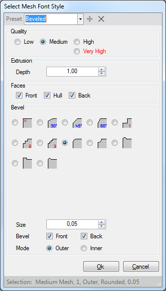

The Style property lists all available Project Font Style presets. Presets can be modified and new ones can be created by selecting Edit... from the drop-down menu. The property Text takes the output of a Text Provider. Text Providers are Block Text, Enriched Block Text, Scroll Text and all Text Effects nodes.
Quality defines the number of vertices used to visualize the rounding of a glyph. Medium quality creates enough vertices for most regular applications. Low quality offers only a very low resolution and should only be used for very small texts. High quality offers very smooth rounding and can be used for most applications. The Very High quality setting renders extremely high resolution meshes and can be used even for very close shots. The Very High quality setting requires a lot of memory however and should therefore be used with caution.
Extrusion sets the depth of a mesh font. An extrusion of 0 will result in a plain 2D mesh. A value of 1 corresponds to the extrusion of Mesh Fonts in Ventuz 2006. Only styles with extrusion can be beveled.
If a Font is extruded, the user can choose which part of the mesh is to be displayed. Front and Back are the 2D Faces forming the shape of the mesh, Hull is the actual extrusion. If no face is selected only the Bevel itself is rendered.
Ventuz offers many predefined Bevel shapes. The bevel Size defines the scaling and size of the actual bevel. If both Font and Back bevel are calculated, the bevel size is restricted to half the extrusion in order to avoid corrupted meshes.
The bevel Mode determines whether the bevel is calculated outwards or inwards. Which bevel mode to use greatly depends on the font used and the general design. Outer bevel changes the font weight. The font appears bolder than it really is. The Inner bevel does not change the font weight but might produce glitches in the mesh and slightly overlapping polygons due to inconsistencies in calculation. A small outer bevel is generally the better recommendation as it produces perfect meshes and displays the font only slightly bolder as it actually is.
