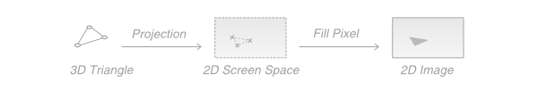

The purpose of a graphics card is to create a 2D image that can be shown on a screen, and that of course as fast as possible. Over the years, two major techniques have been established: Raytracing and Rasterization. The former is primarily used in movie production or anywhere else where the time to create an image is less important than the quality of it. The name Raytracing comes from the process of casting rays through the 3D scene in order to calculate what the user sees at a given pixel from his point of view. In its simplest form, such a viewing ray may bounce between various objects until it hits a lightsource, at which point the algorithms can calculate what color the pixel that cast the ray should be. While this can be quite computationally intense work, raytracing can easily deal with shadows, reflections, transparencies and many other real world phenomena. Although many optimizations have been made over the years and processor power has increased tremendously, raytracing is still too performance intense to create 60 or more frames per second from a scene that constantly changes.
While Raytracing tries to mimic real world physics, Rasterization takes the completely opposite approach: It projects triangles to the screen instead of searching through the 3D space. The vertices of a triangle run through a series of matrices to simulate the effects of a camera such as perspective shortening, thus transforming them from 3D space to a 2D space.
The main part of this projection process is split into three matrices:
Once the 2D vertex positions have been calculated, the triangle can be converted to pixels by connecting the vertices and then filling the interior of the triangle. This step of going from a 2D continuous space to pixels is what gives the whole process the name Rasterization as the 2D triangle is discretized to the 2D raster of pixels.
Rasterization will generate a number of Fragments which can be thought of as potential pixel changes. A fragment contains the 2D coordinates of the pixel it belongs to as well as the color of the triangle at that point. Before assigning that color to the pixel, the fragment has to run through a number of tests which can each reject the fragment and thus prevent the triangle from changing that particular pixel. This can be used to mask off certain parts of the screen or prevent overdraw to simulate occlusion effects as will be described later.

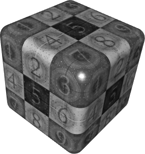

One development which had a profound impact on 3D graphics and realtime rendering in particular was the introduction of Textures. A texture is a 2D image which is mapped to the object surface and used during Rasterization as one of the components to generate the final color of a fragment. Instead of modeling a wall of bricks and assigning it a proper color, one can use a simple rectangle with an image of a wall of bricks. The first and still dominant application of textures is to give a surface the look of a certain material (leather, water, clouds, ...), reducing the number of actual triangles required to achieve the same effect. For example the stitches on a car seat do not have to be modeled but can be "overlayed".
The basic principle of a texture is very simple. Each vertex of a triangle is assigned a new set of 2D coordinates (called U/V to distinguish them from X/Y/Z) to describe which part of the texture should be mapped to the triangle. Usually, the lower left corner of an image is assigned 0/0 and the upper right 1/1, but it is also common to use mapping matrices to modify (scale, rotate and translate the texture) the original U/V-coordinates during Rasterization. It is the responsibility of the designer creating the original model to assign proper U/V-coordinates, same as he decides the position of vertices in 3D space.
Over the years, various other useful applications of textures have been developed. The most crucial one for realtime rendering is called Shadow Baking. Since the pixels in a texture can have any color, the designer is not limited to using them to indicate a material. He can also brighten or darken individual pixels to put highlights or shadows on to the surface. As long as an object does not move relative to the light-source or deform, the lighting information will be plausible. The great benefit of this is not only that the lighting computation does not have to be computed during rendering but that a more complex approach (such as raytracing) can be used to pre-compute high quality shadows that would not be possible at all with Rasterization. Another use for this that greatly increases the visual quality is baking so called Ambient Occlusion. This is where the shadows that are caused by the object shadowing itself, usually where regardless of the light source, there will be less light (such as cracks, indentations and joins) are baked into the model as a texture.

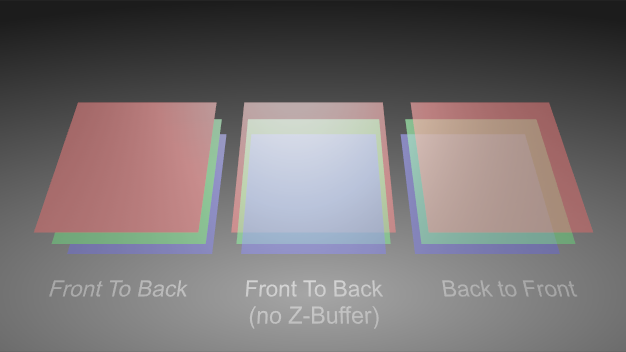

There is however one problem with this approach: The rendering order. Imagine three sheets of glass, each in a different color. Let's say they are, from front to back, red, green and blue. Each has an alpha value of 0.5.
In the left configuration, the red glass doesn't look transparent at all. Why is that so? The render order of the objects is red then green then blue. When red is rendered, the Z-values in the depth buffer are set and no fragment from another triangle with a farther away Z-value will be rendered at all. So there is no chance to blend green and blue because their fragments are discarded before blending.
In the center configuration, depth testing has been artificially turned off. First red is rendered with nothing to blend it with since it is the first thing rendered. Then green is rendered and blended and blue is rendered and blended. Each time the new object will take 50% of itself and 50% from the already rendered objects, so at the time blue is rendered, only 25% of red will be left.
In the right configuration, depth testing has been re-enabled but the rendering order has been changed to back to front: First blue then green then red. When red is rendered, it takes 50% of itself and 50% of the already rendered objects which creates the correct effect.
As opposed to occlusion testing, there is no simple way around having to sort the objects back to front. Note however that the amount of work can be reduced by first rendering all non-transparent objects in any order and afterwards rendering all transparent objects back to front.
