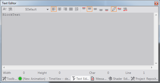

The most common use of the Text Editor is to edit formatted text such as that used by the Block Text node. In this case, the editor looks something like below: The main area is of course reserved to the text input. In the top toolbar are various options that should be familiar to any user that has ever worked with a word processor such as the alignment of the text. The majority of these buttons is directly related to properties of the Text Layout node that is selected and any change in the Text Editor is just a quick way of changing the respective property in the Property Editor.
The bottom toolbar also contains shortcuts to properties usually found in the Property Editor. Depending on the Text Layout node, it can be used to influence the size of the area the layouted text will use, what spacing should be used between lines and so on.

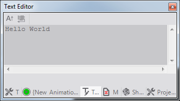

When editing string values (for example for the inputs of String Operation nodes, all invalid properties and functionality, compared to Text Layout nodes, are removed. As a result, the text editor looks rather sparse and functions merely as a way to enter plain text.

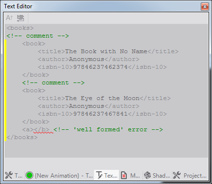

When editing XML data (see [NodeDataXML XML Text node]), the editor features syntax highlighting capabilities. In addition, it checks the content for being well-formed (e.g. a closing tag exists for each open tag, a tag is only closed when all its child tags are closed, ...). It however does not perform any validation against a DTD file which may or may not be specified in the content.

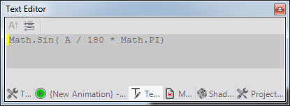

Expressions are small pieces of C# code and the Text Editor features the appropriate syntax highlighting for them. Otherwise it behaves much like a plain text editor. For more information on expressions, see Expression Nodes.
