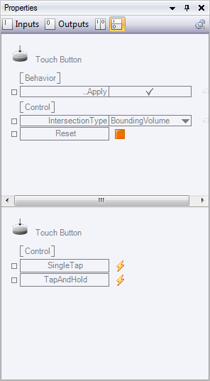

Most properties represent values that influence or are generated by a node. A number of nodes also generate or listen to events that fire when a certain situation arises. The following screenshot of the Touch Button node show both input and output properties and events.
The red square next to the Reset property can be clicked to fire the Reset event, in this case causing the button to reset to its internal state. The output events on the other hand fire when a certain situation occurs, for example the SingleTap event is fired when the user presses and releases
the button within a short timeframe. Apart from triggering the action the button is intended for, this could, for example, also be used to animate the color when the button is pressed to give the user a visual feedback.

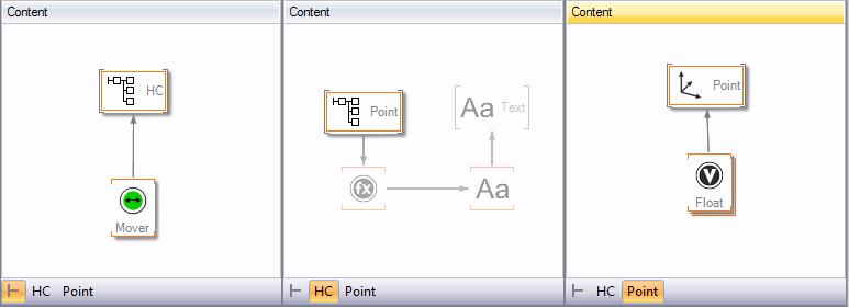

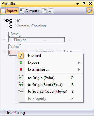

If properties are exposed or bound to other nodes, it might be necessary to see where a value actually comes from. It is possible to navigate to these source nodes via a context menu in the Property Editor.
If one wants to navigate to the node that exposes its properties to the higher container level, a long click
on the interesting property will display a context menu. Not all menu entries are enabled. This depends on the exposing level and the binding state of the selected property. For the navigation in an Exposing hierarchy the menu entries to Origin and to Origin Root are useful. to Origin navigates inside a container to the node that exposes the selected property. This can be any of the Ventuz node. to Origin Root navigates to the root of an exposing chain over multiple container nodes. In this case the destination node can be any of the Ventuz nodes except the container nodes.
If an input property is bound, the menu entry to Source Node will navigate to the node which is bound to the selected property. The navigation to Property is only possible if the Favored option is enabled. In this case a Hierarchy node inherits the favored input properties of all bound nodes for display in the Property Editor. Selecting to Property on such an inherited property will navigate to the real owner of this property.

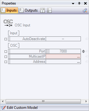

Some Nodes like OSC Input Node or the Script Nodes can have a user-defined number of Properties. The ability to add or remove properties is called a Custom Model. It is usually accessed by a button at the bottom of the Property Editor.
In some of the above screenshots, one of the boxes containing the name or value of a property has a different color than the rest:
