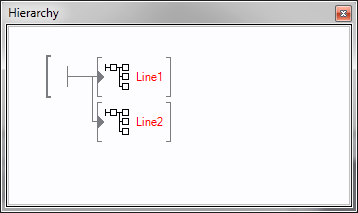

If the nodes that are providing these externals are located inside Containers, the containers themselves can be externalized as well. The container acts as a folder in that case. To externalize a container, the name of the container must as well follow the naming rules of externals before it can be externalized. Open the context menu by press&hold
on the container in the Hierarchy or Content Editor and select Externalize. The name label of the container turns red to indicate an externalized container level. All members externalized inside such a container will be located under this new folder:
/Line1/PositionX /Line1/PositionY /Line1/Text /Line2/PositionX /Line2/PositionY /Line2/Text

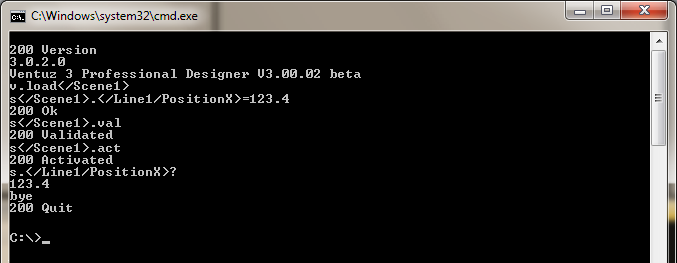

Simple example of a CLI communication.
