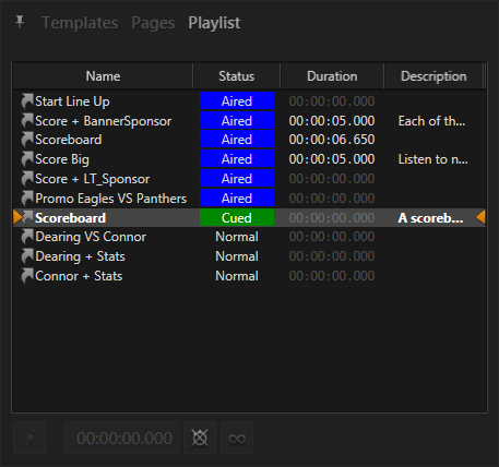

Status
Each playlist entry has a status:
The status of a playlist entry - especially the Aired state - can be reset by selecting entries and then choosing Playlist / Reset Status from the main menu.

Each playlist entry can have an optional duration that specifies how long the entry should be on air. Once that duration is reached, Director performs a take which - in combination with the auto-cue feature - brings the next entry on air. By activating the loop mode, this is a very comfortable way to produce Digital Signage setups where the same set of pre-filled templates is shown over and over again. For example, imagine a conference where displays in the halls show the program of the conference, paging between different tracks and showing sponsor pages every few minutes. If the current on-air item's duration is tracked, the remaining on-air time will be shown in the time code field in the Playlist's toolbar.
To cancel this self-driving cycle of auto-cue and automation takes, either perform a clear or toggle the Ignore Duration Values button in the playlist's toolbar. If this button is activated, Director stops tracking on-air duration for playlist entries. This can for example be used to temporarily interrupt automated playlists to keep a template longer than expected on air while changing the playlist.
