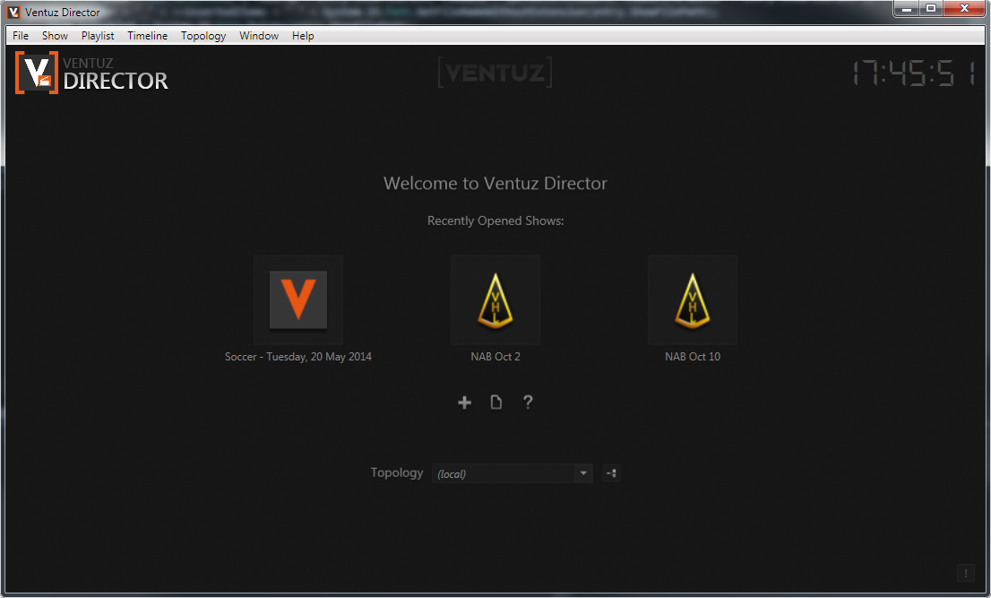

Launch Screen
When launching Director or closing the active show, a simple launch screen is shown inside the Director's work area instead of the usual docking environment. In the center, the three last opened shows are shown. Underneath it are buttons to quickly create a new show, browse for an existing one or open the user manual.
Once a show is opened, Director hides the launch screen and switches to the full docking window environment that will be discussed in the following parts of this chapter.

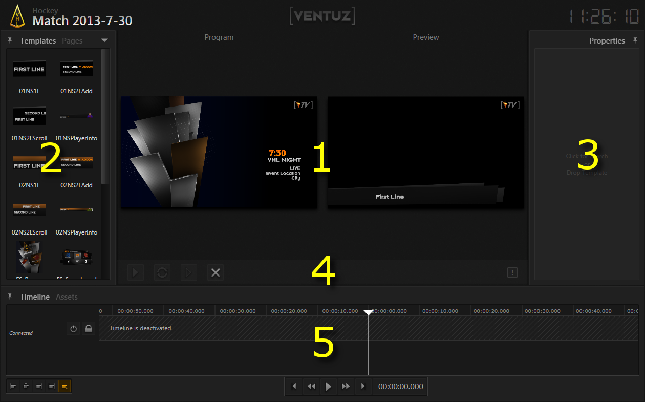

Default Layout
The following screenshot shows the default layout. The remainder of this chapter will discuss window layouts in general as well as some common elements that are always present. Since most element however are optional and can be added/removed depending on the user's workflow, those will be described in their individual chapters.
  1. Preview Windows: Show the output signal

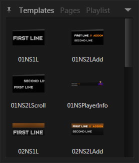

  2. Templates: Browser window for the available templates
  3. Property Editor: Used to edit the values of a cued template
  4. Show Control: Contains the 4 action buttons, a status text and the log info icon.
  5. Timeline: Used to record and playback a show.

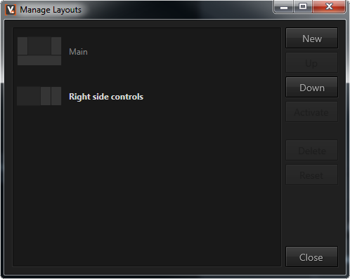

Managing Window Layouts
Since layouts are so powerful, Ventuz not only allows for adding and removing windows but also for switching between different layouts. Window layouts are managed via the main menu Window/Window Layout/Manage.... The list shows a thumbnail for each available layout as well as its name. left mouse button double-click on the name to edit it. By selecting an entry, the buttons for re-ordering, deleting and resetting to default become enabled. To actually activate a layout and use, press the Activate button.
Layouts can also be activated either from the main menu directly or by cycling through them. The respective short cuts can be found in the main menu or on the Shorcuts page of this manual.
Window layouts are stored in the user-settings on a per project basis. So each operator working on a machine has a separate set of layouts for each project but all shows based on a project share this set. For easy deployment, window layouts can also be embedded into the Ventuz Project file. When an operator opens a show based on a project for which he does not have any window layouts in his user settings yet, the window layouts from the project will be copied. Window layouts can be embedded into the project file or restored from it via Show / Project / Default Window Layouts in the main menu.

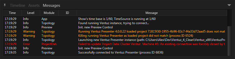

Messages Window & Log File
In the lower right corner of the launch screen is the message icon which also can be found in the same corner when a show is open. Whenever an error occurs, the icon flashes red. By left mouse button clicking on it, the messages window is opened or closed again.
Whenever something important in Director happens, it is written to the log file and thus also to the Messages window. The location of the log file can be found by launching Director and checking the very second line that is logged (the initialization of the logging itself).
By left mouse button clicking on the downward pointing triangle in the right corner of the messages window, additional options appear that allow the user to search for a specific text or change the logging level (e.g. show only errors, no warning).

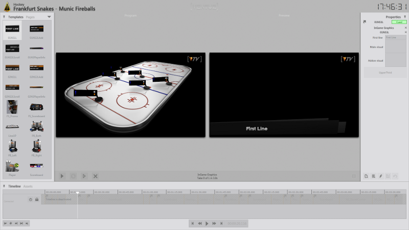

Light Theme
While most operators will prefer the dark user interface for its unobtrusiveness, it can be problematic in bright light situations. Therefore Director contains a second, light theme that uses exactly the same control layout but uses a brighter color scheme and reduces effects such as drop shadows. The active theme can be changed via the Skin submenu in the Windows main menu.
