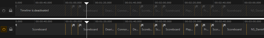

Activation
As mentioned above, all channels on the Timeline are inactive by default. This way neither any user operation is recorded nor does any information stored on the timeline interfere with what the operator wants to do. A channel is activated by left mouse button pressing the toggle button on the far left side of the channel's time strip.

Current Time
Inside the Timeline window, the current point in time is visualized as a white vertical line with a triangle on top. The Timeline Item that lies beneath it is currently on air (in this case "Scoreboard") and the next one will automatically be cued ("Deari..."). The orange lines symbolize Takes. So shortly after 01:20:000, a take will be executed to bring "Deari..." on air and thus take "Scoreboard" off air.

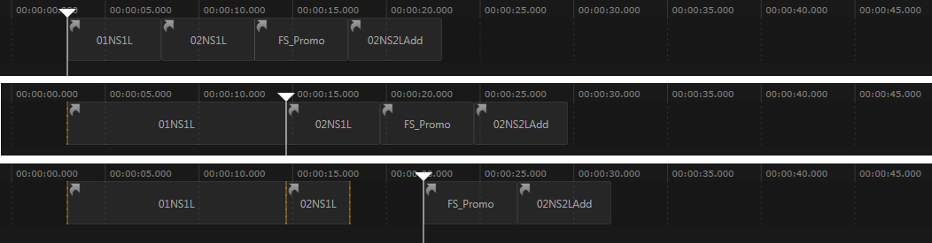

Let's have a look at what happens as time moves on. The following example shows three different points in time within the same show:
  1. In the first image, the show has just started and there are four items cued. As time progress the cued item stay cued and thus move forward with the current time marker.
  2. Shortly after the first image was taken, the operator performed a Take (orange line). As time progressed, the first item stays on air and its length grows with the current time marker.
  3. Shortly after the second image was taken, another take was performed followed by a take out. As time moves on, the gap between the last item on air and the next cued item becomes bigger as nothing has been on air.

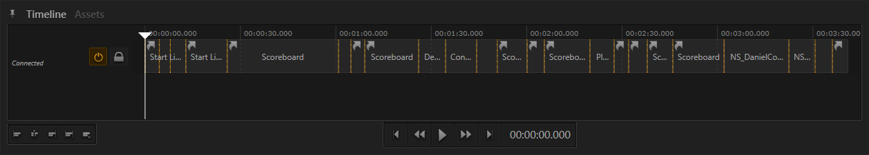

Transport Control
The current point in time within a show is controlled by the Transport Control at the center-bottom of the Timeline window. This should look familiar to anyone that has used an audio/video application. When pressing the start button, time begins to run as can be seen by the numbers on the right side. They indicate the hour, minutes, seconds and milliseconds since the start of the show.
Another way to change the current time is to left mouse button drag the current time marker inside the Timeline to the correct position. This is called Scrubbing. While scrubbing, time is paused and Director will skip animations to update its program and preview pipe to the new position as quickly as possible. If holding shift while scrubbing, the current time marker will snap to the time resolution shown in the time bar.
There are two ways to navigate inside the Timeline. For one, by moving the mouse cursor over the time bar portion at the top of the Timeline, the cursor changes to horizontal arrows. left mouse button dragging horizontally will change the viewing window while dragging vertical will change the zoom.
The other way are the 5 viewing buttons in the lower left corner of the Timeline window:
