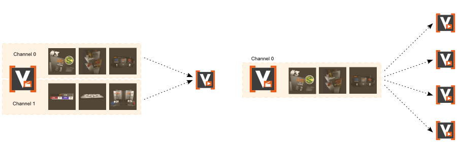

As discussed in previous chapters, one of the fundamental design principles of Director is the separation of content and the actual rendering system via channels. A channel is a stream of content (specifically templates being cued, filled with values and taken on air). Where that content is rendered is not part of the show but part of the topology. This allows an operator to create a show, pre-fill and test playlists and timelines, create pages, develop window layouts and everything else on the go on his laptop. Once he comes to the venue where the event is taking place, he simply switches the topology and is ready to run the same show on a multi-machine setup.
So what is a topology? Think of it as a blueprint of the environment in which Director works. It defines how many machines should be in each rendering cluster, from which channel they can receive template commands and which outputs are made available to be shown in the preview windows inside Director. It does not enforce any machine setup information like machine/group IDs, the render setup to use or how the rendering pipes are configured in those machines. Instead it presents the state machines are in and visualizes potential problems.

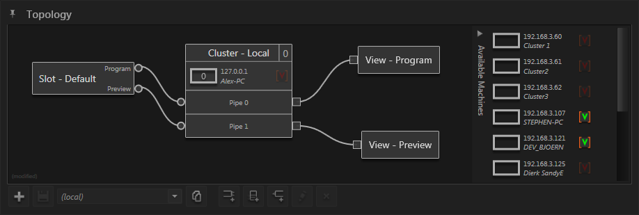

Machines are represented by a rectangular box with their IP-address and name next to it. The following shows a cluster of three machines in various states:
The same information is also available for machines that have been detected on the network but are not currently used in the topology: the list of available machines. This part of the topology editor is collapsed by default and can be opened by left mouse button clicking on the label "Available Machines" on the far right side of the topology editor. For a machine to be listed here, it has to have a running Ventuz Machine Service (VMS).
As will be seen later, the local machine has a special role and is never listed in the available machines list.
Further information about a machine is displayed when hovering the mouse cursor over the machine's name. In a similar fashion, information about the runtime is shown when hovering over the Ventuz Runtime icon.

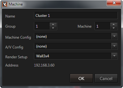

Inside the topology, a machine never exists on its own but is always part of a cluster, even if that cluster only consists of that one machine. The reason for this is that the cluster provides and manages the outlets Director can connect to in order to send cueing commands or receive preview outputs.
There are various ways to create a cluster: The add cluster button in the topology editor's toolbar, the context menu when right mouse button clicking on the background of the topology editor, but the quickest is to simply left mouse button drag a machine from the available machines list to the background of the topology editor. Regardless of which way is used, the cluster edit dialog is opened in which a name can be given, the number of machines in the cluster is specified as well as whether it is a single or dual pipe cluster. The same dialog can be accessed by left mouse button double-clicking on a cluster's name or via the cluster's context menu.
Note that the pipe count is again only a planned goal. It specifies that the machines in this cluster should have that amount of pipes, the actual pipe count is dependent on the configuration of the machine itself.

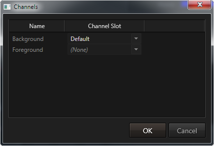

A show is completely agnostic to what topology it is running on as everything is routed through channels. But of course a channel has to know where in the topology it can send its commands to. Each channel slot represents a point in the topology where a channel can potentially be attached to. It has a program and preview outlet that can be connected to clusters but does not have any functionality per se. All it got is a name and its internal ID.
Each channel in a show has a channel slot ID it tries to connect to in the currently active topology when a show is opened. This connect is re-resolved whenever the channel is mapped to a different channel slot or the underlying topology changes (e.g. the operator switches to a different topology). The ID of a channel slot can be changed via its editing dialog by left mouse button double-clicking on a channel slot or via the edit entry in its context menu. The other end - the ID a channel is mapped to - can be changed in the Channel Manager which is accessed via Show / Channels in the main menu.
At the time of writing, a topology usually only needs a single channel slot as there is only one channel in a show. However, multi-channel support is already in development and will be added in a future version.

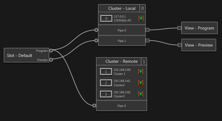

The program and preview outlets of a channel slot are what is used to connect a channel to a cluster (and therefore its rendering machines). The program outlet represents what a user sees on air. As long as a Director operator only cues a template, no visual change will occur on the program port. Director only sends cueing instructs on the program outlet and waits for the operator to perform a take.
The preview outlet on the other hand receives cue/take instructions based on the template the operator is currently editing. If an operator cues a template, it will send a cue and take on the preview outlet to get the template to the visual output (and thus making it available in the preview render window).
So while the preview outlet is optional, the program outlet is usually connected to Pipe 0 (the main output pipe) of one or more clusters by left mouse button dragging from the outlet to the port on the cluster. The example above shows a typical case: The local machine is serving as a rendering backend for the program and preview windows inside Director. The actual output for the audience is generated on a separate, three machine cluster which doesn't even need a preview pipe. It's Pipe 0 is also connected to the program outlet of the channel slot so the local and remote cluster both create the same visual output on their Pipe 0.

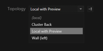

Managing Multiple Topologies
To create a new one, use the new topology button in the topology editor's toolbar which will launch the topology creation wizard. Topologies are XML files that are stored in Ventuz's configuration folder. In fact, the actual rendering machines have no knowledge of the topology. They only receive commands from Director and are unaware of other machines. Topologies are also agnostic to what show/project they are about to run, so they are shared among all projects on a Director machine.
Next to the drop down box to choose the active topology is the button that opens up the topology manager. In this dialog, existing topologies can be duplicated or removed via the corresponding buttons or renamed by left mouse button double-clicking on an entry.
Director has an application setting that decides which topology is loaded during application launch. It can be accessed via Tools / Options in the main menu. By default, the last used topology will be activated. However, it can also be configured to always start with a local setup or any specific user-created topology.
