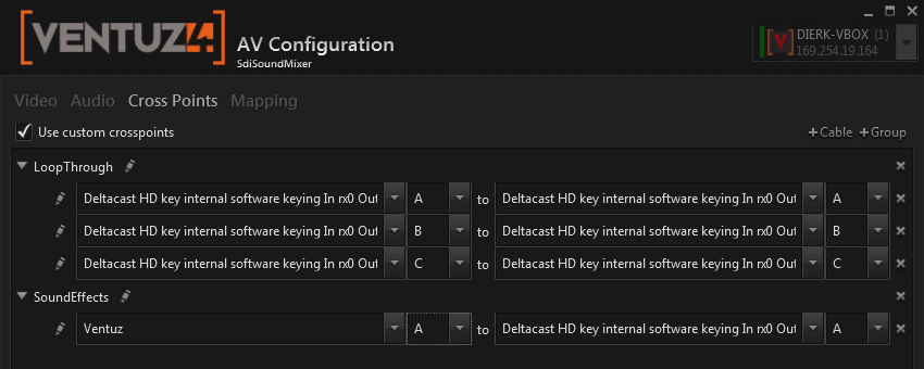

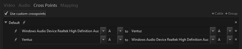

Comprehensive Audio Mixing
Virtual audio cables can be routed from any video input or Windows audio input device to any other video output or audio output device. Each cable comes with delay, volume and balance control.
Each stereo pair is handled individually, so routing from input 1 channel 5/6 to output 2 channel 1/2, or routing a 5.1 signal by using 3 stereo pairs is simple.
Ventuz can add sound clips or sound from video clips to the mix, or analyze sound from input sources. Similarly, audio can be delayed or compensated in order to match video or other delays.
The delay is for more than just adjusting for video input processing times. For some video formats, the number of samples changes from frame to frame, and input and outputs may be in a different position in the cycle of changing sample counts. For asynchronous streams, additional buffering is required. The delay will calculate a small but safe amount of buffering dependent on various attributes of the streams.
The virtual audio cables operate in stereo pairs. Each input or output has its certain number of stereo pairs (e.g. SDI has 8 pairs), and via the routing in the AV Configuration editor, the delays can be mixed and matched from input to output extremely flexibly.
An audio routing can handle multiple cables per input and output, with smoothing to prevent clicks or popping when changing volume or panning.
All audio processing in Ventuz is done at a sample level at 48kHz, and conversion to other sample rates is handled within the ffmpeg engine. Because Ventuz works with stereo pairs, 5.1 or devices with more outputs are simply divided into stereo pairs. Similarly, mono devices are converted into a stereo pair.

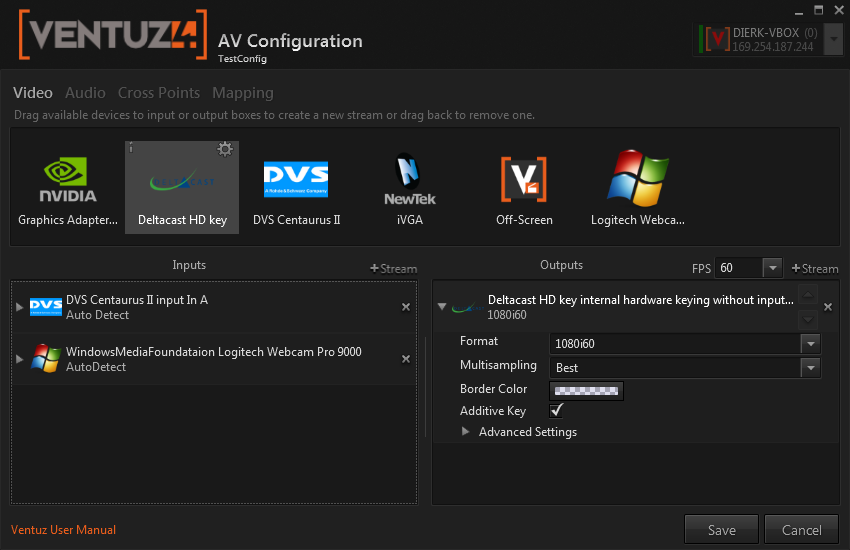

Video Outputs
It is best to specify the frame-rate before creating any output streams. This is done with a drop-down box just above the Outputs window.
The AV Configuration editor displays all supported devices if they are found on your system. The current Licensed Output Options may deny the creation of certain streams! The Ventuz PLE version has no restrictions - all devices can be tested without a purchased license but the output will be branded with a Ventuz logo.

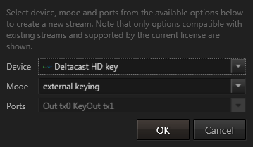

Video output streams are added by dragging a device from into the Outputs window. When doing so, a dialog pops up that allows users to specify some options:
In DirectX Output Mode only one output is supported since Ventuz always runs on a single GPU/Adapter. Combinations between DirectX-Fullscreen and SDI, for example, is not possible!
When configuring multiple inputs and outputs on the same card, arbitrary hardware limitations might reduce your choices.
If the configured output streams are only of type Shared Surface the outputs will be branded with a Ventuz logo if no appropriate License is available.
Video Inputs
Inputs are dragged into the Inputs window just like outputs are dragged into the Outputs window. There is only one mode: input.
Some output modes come with inputs, in this case these inputs automatically appear in the Inputs window. The option for these dual input/output streams are mirrored.
These inputs can be used in Ventuz with the Live Video node.
The video format of inputs can be configured independent from the video format of the outputs. For best results, the frame rate should be the same as the output and all signals should be genlocked together.
Most video boards support Autodetect mode. Should the video mode of an autodetect input switch, the video engine will synchronize on the new signal. If the video board is not in autodetect mode, it will report signal lost until the stream switches back to the configured video format.
A list of available formats can be found here, but not all boards support all formats.

Video Device Information and Options
Each video device has two little buttons when hovering over the device icon.
The little 'i' will open a box with information about the hardware.
The little gear-icon will open a device configuration dialog. The selection of available options depends on the kind of the device and it's capabilities.
Available options are:
Genlock Source: Select the source for the genlock. Most SDI-boards support SDI-inputs and a special reference signal inputs. To disable genlock choose internal.
Genlock Format: Select the format of the genlock signal. Usually the genlock will lock on a signal much faster if it is not in Auto Detect mode.
Genlock H Offset and Genlock V Offset: (Live Option) This allows to offset output streams from the genlock signal. When the Genlock Format is not known, some boards only allow vertical (pixel) offset and no negative offsets. If the format is known, Ventuz can automatically convert (possibly negative) H & V offsets into a positive vertical offset independent from the boards capabilities.
Watchdog Timeout: (Live Option) Set the hardware watchdog of the device. The value is in milli-seconds. 0 disables the hardware watchdog. Do not confuse this device feature with the software watchdog.
Multi Channel: DVS boards can be switched between single and multi-channel modes. This usually happens automatically, but if there is some confusion, set it manually.
Video Norm Input X: Deltacast DVI capture boards require manual specification of the kind of signal to expect.
Preserve EDID: This tells Deltacast DVI capture boards to preserve a pre-programmed EDID (monitor id).
Verify Frame Rate: This is for Video for Windows inputs (like Webcams). When auto-detecting a signal, this verifies the frame rate. This is recommended, but disabling this may sometimes help locking on to input signals that are otherwise refused.
Auto-Detect 4k Modes: Some SDI boards receive 4k streams as quad-link HD or quad-link 3G streams. Unfortunately there is no standardized marker to distinguish a quad-link 4k streams from 4 normal streams. Normally, Ventuz will interpret a quad-link 4k stream as four independent streams. With this options Ventuz will assume that 4 identical streams will form a quad-link 4k stream if possible. Some streams can not form quad-link 4k, like interlaced or SD streams, these will still be handled as individual streams.

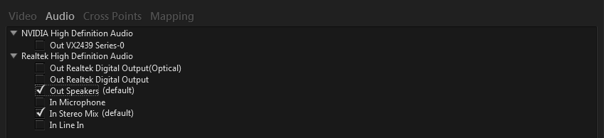

Audio Devices
In the Audio section displays all pure audio devices available in the system along with their supported streams (input and/or output). Simply selected the streams you want to use. The default Windows input and output streams are marked with the text (Default).
If portable devices such as USB headsets or USB speakers are used Ventuz will reports errors if the device is turned off or has been disconnected prior start-up of Ventuz. Some devices may change their stream configuration depending on the connected physical cabling. In such a case Ventuz will also report a missed stream on start-up.
Cross Points
In the Cross Points section, audio inputs and outputs can be connected. Such a connection always works on a stereo pair. A typical SDI device has 16 channels, and therefore 8 pairs. A sound-card configured for stereo has one stereo pair, one configured for 5.1 surround has 3 stereo pairs. In this manual the term Cross Point is also referred as Cable. These two terms are identical!
The Ventuz Video Engine does not support 3D or surround sound natively. Only PCM stereo is supported. The Sound 3D Node connects directly to a Windows 3D Audio Device without passing its audio trough the Ventuz Audio processing! Hence it is not possible to generate 3D sound and output it on SDI or other hardware of the video engine.
The Web Browser always outputs on the default Windows Audio device. Sound played by the Web Browser is not passed through the Ventuz Video Engine and is unable to be routed to SDI or other supported devices.
Stereo pairs are named A, B, C and so forth. Where A maps to the channels 1 and 2 (also referred as 1/2), B to 3/4, etc.
To enable Ventuz to interact with the audio a virtual Ventuz device exists. It provides 8 Record and 8 Playback stereo pairs. If Ventuz needs to receive audio from a stream (e.g. for the FFT Audio Analysis a cable from that stream has to be connected to a Record pair of Ventuz. If Ventuz outputs audio a Playback pair must be connected to the desired output stream or output streams. Any audio related node in Ventuz selects the Record or Playback pair to delegate the audio. The wiring defines how the audio is routed.
By default the Use custom crosspoints check box is unchecked. In that case Ventuz automatically subsequently connects the first stereo pair of all configured audio and video stream to the Ventuz Record Pairs. And all available audio outputs on all audio and video streams to the Ventuz Playback Pairs. All automatic cables are grouped is a single cable-group called Default. If the Use custom crosspoints is checked that cables have to created manually.
Ventuz works like a giant matrix mixer. Any input stereo pair can be mixed to any output stereo pair. In practice usually only a few such cross points are needed. Each line in the configuration represents one cross points. Each cross points consists of an input device with stereo pair and an output device with stereo pair.
Cross Points (or cables) are combined named groups. Inside Ventuz, the volume and stereo panning for each group can be automated by using the Volume Control Node. If many stereo pairs have to be automated in parallel, grouping them and giving the group a descriptive name can avoid confusion.
Please make sure that only one Volume Control Node controls a group at a time. Concurrent controlling would cause unexpected behavior. The rules here are last-in-last-out; the last access to the group in the current frame will set the parameters. If concurrent access happened within one render cycle a silent warning message will be logged.
Each cross point has its own Delay value. Although the default value is 0 it doesn't mean that there's no delay on the audio. The Ventuz Video Engine takes care about the minimum audio delay required to be in-sync with the video output. The user can adjust the delay value in milliseconds, but as long the actual minimum delay is not exceeded no additional delay will apply. The minimum delay depends on the entire structure of configured streams and is currently not displayed to the user.
Crosspoints Example: Adding Ventuz to SDI
Let's assume we don't have a hardware keyer (internal or external) that supports audio mixing. In this case, we must use the software keyer. This example shows how to pass through a 5.1 audio signal (not dolby) from SDI in to SDI out and add stereo sound effects from Ventuz.
The AV config for such an situation looks like this:
We have two groups: the first group (LoopThrough) loops the SDI audio input to the SDI audio output. The second one (SoundEffects) adds Ventuz audio in stereo to the SDI output. The volume of each group can be controlled with the Volume Control Node. For instance, one could duck the SDI loop-through before playing sound from Ventuz.
A common mistake is trying to loop SDI output through Ventuz. This will not work. Imagine working with normal audio equipment. Ventuz audio output is like a synthesizer. To add a synthesizer to the mix, one does not loop the signal through the synthesizer, the synthesizer is just connected to the mixer.
The SDI input is like a microphone input, and the Ventuz output is like the output of a synthesizer.
This is confusing. Instead of thinking in terms of inputs and outputs, think in terms of audio sources (left side of the cross-points window) and audio destinations (right side), from the perspective of a matrix mixer. So the Ventuz output is an input (source) to the mixer.

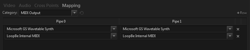

Depending on the number of configured output pipes (video output streams), the device mapping shows one or two colums of mapping entries - one for each pipe. As said, the default mapping maps all indices one-to-one - the editor only displays the same number of rows as physical devices exist for the selected device type.
You can add more rows but as long as these rows do not change the default one-to-one mapping they won't be saved! If the configuration is loaded in the editor later these rows will be gone.
Example
To configure the two output pipes so that each of them has its own live video input as its first device (ordinal 0) use the following mapping. Please note that the second row (ordinal 1) contains a NONE entry for both pipes, because the endless mapping would map ordinal 1 to device 1 if no explicit entry exists for ordinal 1. In this case both pipes would resolve to device 1 (Deltacast HD key input In rx1) on ordinal 1.
Multiple Logical Device Ordinals are allowed to map to the same Physical Device. Simple add a new row and select the physical device again.
Logical Device Ordinal can also map to a NONE device. No device will be address and the node will operate without device (no physical input or output)
The Reset button next to the device type selector resets all mapping entries. A list of all existent devices will be shown in the same order as they appear by the enumeration. A one-to-one mapping for all output pipes is the default mapping.
