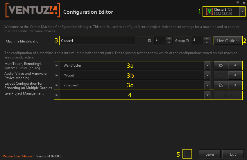

The Ventuz Configuration Editor consists of several sections which are described here:
  1. Selection of a single Ventuz machine or selection of a group of Ventuz machines (Cluster)
  2. Editing of Live-Options (only in single machine mode)
  3. Configuration of the Ventuz Config (Name, ID, GroupID and selection of sub-configurations)
    1. Edit and administrate Machine Configuration (only in single machine mode)
    2. Edit and administrate AV Configuration (only in single machine mode)
    3. Edit and administrate Render Setup (in single and group machine mode)
  4. Live Project Management (Upload Ventuz project, Start and Stop Ventuz Runtime)
  5. Log Messages: When left mouse button clicked, shows the message log window.

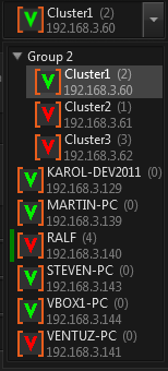

The Machine Selector shows all machines discovered within the network. The Ventuz Machine Service broadcasts its VMS signature periodically. The Machine Selector receives these messages and add the entries to the selector. Machines without VMS running can't be discovered and configured!
The entry with the green bar on the left marks the local machine. The local machine is the default selection when the Ventuz Configuration Editor is started.
The selector automatically groups all machines with the same GroupID. To select a group click on the group label (here Group 2). Only Render Setups and Project Management are available when a group is selected.
Each entry has a colored Ventuz icon. The color indicates the current state of the running Ventuz process on that particular machine:
OK Ventuz is connected and running
INIT Ventuz is connected and running, though no project is loaded yet
OFFLINE Ventuz is not connected
TIMEOUT No VMS discovery message received

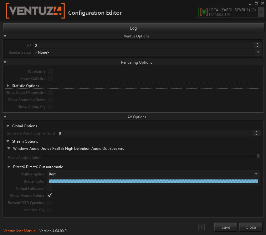

Some settings from all configuration areas as well as many settings for the renderer can be adjusted on-the-fly by entering the Live Options on a machine with a running and connected Ventuz Runtime process (green or yellow state).
Currently there are three areas that have live options available:
Please note that Live Options can only be saved if the corresponding configuration is not set to (None). The actual values of the settings are injected into the currently loaded file and it will be saved to disk. If there is no configuration file Ventuz can't save it...
Ventuz Options
The ID and the currently used Render Setup can be changed live. Changing these values doesn't affect the saved Ventuz Configuration as long the Live Options have not been saved.
Rendering Options
These options change some renderer-specific settings. The same options are also available in the Renderer Windows in Ventuz Designer.
Please note that the Rendering Options cannot be saved! After a restart of Ventuz all options fall back to their default values.
AV Options
Some board and audio and video stream have settings that only can reasonably adjusted while Ventuz is running (Genlock delay, audio gains and delays, etc). The live AV options make all settings available that are changable on-the-fly. Saving the AV part of the Live Options will overwrite the current AV Configuration File. If no configuration has been set (None) the live edited values cannot be saved!

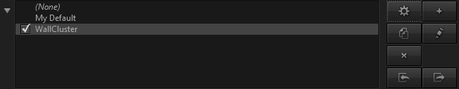

Each of the three sub-configuration has an Administration Area. This is shown if the expander left of the selection box is clicked.
The Administration Area shows a list of all available configurations where the checked entry marks the currently active file.
Several action can be performed on the selected entries:
Edit selected entry Create new entry
Duplicates selected entry Renames selected entry
Deletes selected entry
Imports a file Exports selected entry
The Edit and New buttons are also available in the compact view of each sub-configuration section though the shown entry is the check and selected one at the same time. (always the active configuration is edited)
Editing an entry switches to the corresponding sub-configuration editor. Each sub-editor has its own Save and Cancel buttons. These buttons affect only the current sub-configuration being edited. The Save button on the Ventuz Configuration page only affects the settings of the Ventuz Configuration which references the sub-configurations by name.
Importing and Exporting is just a simple way to copy the actual configuration files from/to the configuration folder. If a remote system or group of machines is configured this feature becomes very helpful!

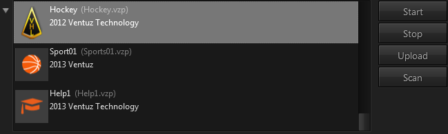

The Live Project Management allows a project found on the target system to be selected and Ventuz Runtime to be started with the selection. The simple view can also be expanded to show more options:
The displayed list shows all projects found by VMS on the target system. If the user hovers the mouse over one entry a tooltip popup shows more details about the project. The project files must be stored in the project folder configured in VMS. The default folder is
C:\Users\Public\Documents\Ventuz4\Projects
Please note that only unique projects are displayed in that list. If a project with the same ID appears multiple times on a system or - in multi machine mode - a project ID doesn't exist on one or more system it won't be displayed!
In expanded mode the Live Project Management can perform several actions:
Start the selected project. Any previously running Ventuz Runtime will be closed before!
Stop (kill) any currently running Ventuz Runtime.
Upload a Ventuz Project (VPA or VPR) to all selected machines and initiate a re-scan on VMS.
Initiate a project scan on all selected target machines.
Before starting or stopping and Ventuz Runtime processes make absolutely sure that you're connected to the correct machines! To disallow closing processes accidentally you can set security settings on the VMS.
