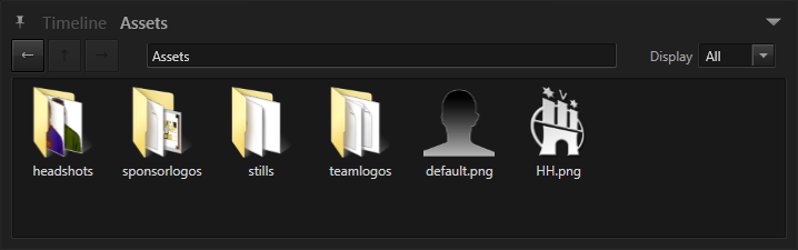

To separate end-user assets from meshes, textures and so forth that are used inside a Ventuz scene to render the template itself, all assets are stored in the Assets sub-folder inside a Ventuz project. The contents in this folder are shown in the Assets docking window which can be found underneath the Timeline window in the default window layout.
The assets window has been designed to match the standard Windows Explorer and should thus instantly feel familiar to most users. In the image above, it shows the content of the asset folder itself. left mouse button double-clicking on any of the folder icons steps into the folder. The three navigation buttons in the top left corner allow for stepping back and forward in the navigation history as well as going up to the parent directory.
The text in the center top shows the current folder name. To the right of it is the filter for specific file types (e.g. to only show all images). Further options are available when clicking on the docking window options button in the top right corner.
By setting the check mark to the left of any of the options, the respective control is added to the toolbar inside the assets window. The current location and all of the configuration settings are stored as part of the Window Layout. One can also add further windows to have separate docking windows for different types of locations and/or assets. For example, a nice big thumbnail view for headshots but a compact filename list for movies in a certain folder.
