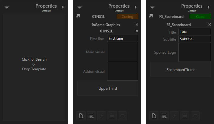

The Property Editor changes its appearance to match data values of the cued template instance. The following image shows the Property Editor in three different states. In the left version, no template is cued and therefore the Property Editor is empty. Once a template is cued, a header and footer become visible as well as the data fields for the template.

Let's take a closer look at the content of the template instance shown in the middle of the screenshot above:
The label "InGame Graphics" as well as "01NS1L" represent templates. Ventuz Director uses a highly flexible system of templates and sub-templates. Templates can have slots for optional additions that can be added and removed from it's parent template. For example, imagine a scoreboard that has an optional sponsor area that moves out of the scoreboard and sticks to its side. The scoreboard would be one template and the sponsor area a sub-template for that template. It is up to the operator to extend the original template with the sub-template or not!
Such an extension slot is represented by a light gray box. In the example, the box at the bottom of the content visualizes that a sub-template of the type "UpperThird" can be inserted here. This can be done by left mouse button clicking on the box and a selection of fitting templates will be presented. The inverse operation is also simple: To remove a sub-template, left mouse button click on the cross to the right of the template name. In the example, both the "InGame Graphics" and "01NS1L" template can be removed.
As stated before, Assets are represented by placeholder boxes. In the example above, both "Main visual" and "Addon visual" can each hold an image. Either drag and drop an image from the Visual Browser or left mouse button click on the empty box to again open a selection of fitting images.

If any data fields are changed, a red bar will appear to the left of the respective field. This visualizes the value is different from the original. Those changes can be saved or reverted using the respective buttons in the footer.
