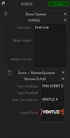

What has been omitted in the previous explanations of the Property Editor is the arrow icon in the top-left corner of the Property Editor. This represents a reference to another content element inside Director. For example, when cueing a template by left mouse button double-clicking on a thumbnail in the Template Browser, Director keeps track that the template instance was created based on that blank template. This is called a reference. When hovering the mouse cursor over the icon, a popup will appear that lists the reference for the template instance.
Depending on how the cued content was created, there can be further icons to the left of a template name. In the example below, the part below "Show Opener" has been created based on a Playlist Entry (four vertical lines) and the part "Score + BannerSponsor" based on a Sub-Page. To make it easier to spot which parts belong to which, a box is drawn around the respective areas.
