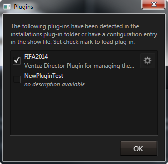

To enable a plug-in's functionality, open the show it should be used in and go to the Plug-ins Manager which can be found in the main menu under Show / Plug-Ins .... Set the check mark next to all plug-ins that should automatically be loaded whenever this show is opened.
In the image below, there have been two plug-ins installed but only the first is activated for the show. The button to the right of the name shows that this plug-in can be configured. By pressing it, the plug-in's configuration dialog opens.
The information which plug-ins should be enabled and their respective configuration settings are stored in the Director show file. To use a common set of settings for all shows based on a project, an operator can embed default settings into the Ventuz Project file via Show / Project / Show Defaults... in the main menu. Those will be used as defaults for each show that is newly created for this project.

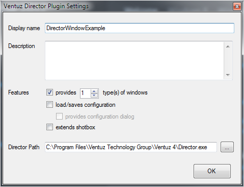

To start a new plug-in, select File/New/Project... from the Visual Studio main menu. If the extension is correctly installed, a new entry Director Plug-In will be available in the Visual C# section and in the Visual Basic section. (This text will choose C# as programming language.) Select this entry, choose a name and location for your plug-in project and press OK. Next, the Ventuz Director Plugin Settings dialog will appear.
Display name and description of a plug-in are end-user information that will be used inside Director, for example in the plug-in manager. They have no relevance for the functionality of the plug-in but make it easier for an end-user to identify and use a plug-in. The set of controls below is for specifying what capabilities the plug-in will support. For this example, create a plug-in that provides one new window type. Finally, to test a plug-in, a Director instance is required. The extension will auto-detect the latest Ventuz installation and use that application path. If for some reason the auto-detection fails or the plug-in should be developed against a specific Director version, the appropriate Director Path can be entered in the first text box.
When pressing OK, Visual Studio will create a skeleton implementation of the plug-in. In our case, it contains the following files:

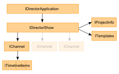

In order to cue a template, we have to retrieve it from the set of available templates and then tell Director where to cue it. In this example, we'll use the Hockey demo project that ships with Director. It contains a template called NS1L that we want to cue whenever the operator clicks our cue button. As shown in the diagram above, the templates can be accessed by using the active show to get the ITemplates interface.
The quickest way find out what's accessible via the plug-in API is to double-click on the Ventuz.Director.Shared entry under References in the Solution Explorer. This opens the Object Browser window where one can navigate the various interfaces and their methods.
ITemplates implements a method that retrieves a template by its name (the internal name the author of the template gave the template state which may or may not differ from the end-user name shown in Director). To retrieve the template called "NS1L", we go through the plugin interface as follows:
Ventuz.Remoting4.Templates.Template template = this.Plugin.Application.Show.Templates.GetTemplate("NS1L");

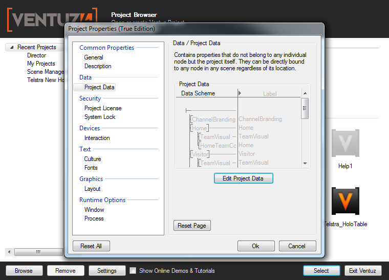

Another common use case is developing a custom control panel that should modify project data (e.g. goals scored in a match). We'll use this to give an example on how to create WPF binding between a UI element and its respective data object. Let's assume we have a color each for the home and guests team that is part of the project data. How do we achieve something like shown in the following screenshot?
This example contains a number of standard WPF mechanisms like bindings, resources, converters, and using components from other DLLs. It is beyond the scope of this document to give the reader even a concise overview over WPF functionality and therefore this is only intended as something to follow through while using some other form to learn WPF!

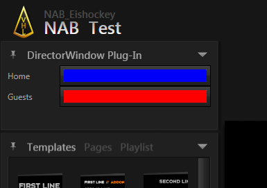

        <TextBlock Grid.Row="0" Grid.Column="0" Text="Home" VerticalAlignment="Center"/>
        <ventuzControls:ColorPicker Grid.Row="0" Grid.Column="1" Height="30"/>
        <TextBlock Grid.Row="1" Grid.Column="0" Text="Guests" VerticalAlignment="Center"/>
        <ventuzControls:ColorPicker Grid.Row="1" Grid.Column="1" Height="30"/>
    </Grid>
</UserControl>

System.Windows.Data Error: 5 : Value produced by BindingExpression is not valid for target property.; Value='Color [A=255, R=25, G=25, B=254]' BindingExpression:Path=Application.Show.ProjectData.Data.Home.HomeTeamColor; DataItem='Plugin' (HashCode=50714607); target element is 'ColorPicker' (Name=''); target property is 'DisplayColor' (type 'Nullable`1')
In plain English, both ends don't match! We need a converter for this which luckily is also part of Ventuz.WPF.dll. We add another namespace:
xmlns:ventuzConverters="clr-namespace:Ventuz.WPF.Converters;assembly=Ventuz.WPF"
Then we add an instance of the RGBAToColorConverter as part of our UserControl's resources (usually added as the first thing right after the end of the opening UserControl tag).
<UserControl.Resources>
    <ventuzConverters:RGBAToColorConverter x:Key="colorConverter"/>
</UserControl.Resources>
And finally, we use the converter in our bindings:
<ventuzControls:ColorPicker Grid.Row="0" Grid.Column="1" Height="30" DisplayColor="{Binding Application.Show.ProjectData.Data.Home.HomeTeamColor, Converter={StaticResource colorConverter}}"/>
<ventuzControls:ColorPicker Grid.Row="1" Grid.Column="1" Height="30" DisplayColor="{Binding Application.Show.ProjectData.Data.Visitor.VisitorTeamColor, Converter={StaticResource colorConverter}}"/>
Now everything works as expected. When the plug-in window is opened, the color pickers will contain the current color set in the project data and when making any changes, they are reflected inside the presenter runtime.
