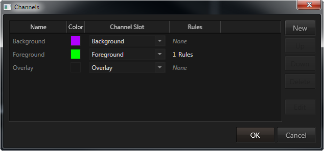

When creating a new show, by default, a channel is allocated for each Channel Slot in the active topology. Since the default topology is a local setup with just one Channel Slot, this results in the familiar setup a show containing only one channel. Additional channels can be added/removed via the Channel Manager at Show / Channels... in the main menu. Each channel has a name that is used throughout the application, a channel slot in the Topology active topology it is assigned to and an optional set of rules. When
double-clicking on a channel or selecting one and pressing the edit button, its properties can be modified.
The most important information for a channel is of course the Channel Slot it is assigned to. Without a channel slot, the channel will not be able to communicate with the rendering backend and therefore to cue/take any content.
Although the channel manager shows the names of the channel slots in the active topology, the channel actually stores the ID of the channel slot. This way different topologies can be used for the same show and channels will reconnect automatically if the new topology contains a slot with the same ID. If a slot is not available, the channel will log an error message that it is disconnected and show a red status message in the Timeline window.
Each channel can also be assigned a custom color. All windows that operate on a specific channel will color their outer border based on the channel's color. This is an optional feature but very useful when working with multiple playlist or property editor windows.
Finally, channel rules can be used to modify a channel's cueing behavior. They will be discussed later in this chapter.

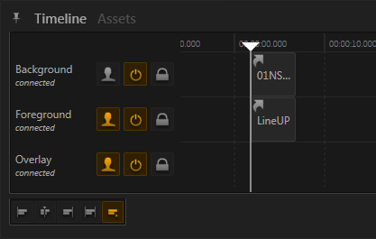

Each channel-based window contains a button showing a human shape to enable/disable user-interaction on that channel. If an operator cues a template, presses F1 or the take button in the Show Control, that action is performed on all channels that are user-interaction enabled. If for example one channel is automated via a Playlist, one generally will want to disabled user-interaction so pressing F1 will not disturb its operation. In the screenshot below, all channels have activated their Timelines but the first channel has its user-interaction disabled.
Although the user-interaction mode can be used to have a channel completely ignore all take/cue operations done by the user, there often are situations where one wants to do a take on only a specific channel. For this reason, the playlist, property and timeline window each have configurable button toolbars that can customized via the configuration option button in the top right corner of a dockable window. These buttons work exactly the same as the ones in the Show Control but act only on that specific channel.
