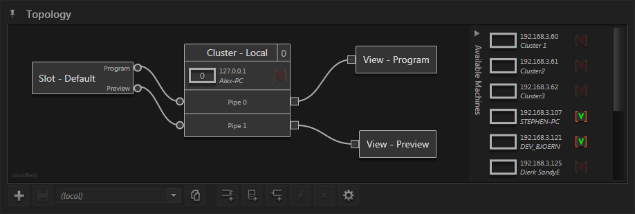

The topology editor has a special role in the user interface in that it is always part of the window layout, same as the message log. The easiest way to access it is via the topology button on the empty workbench (to the right of the topology chooser) or the same button in the show control once a show has been opened.
The editor has three distinct parts:
The image above shows the state of the topology editor when no show is opened. While running a show, the available machines list and the editing toolbar are automatically removed.
The editor has two distinct modes of operator, depending on whether a show is open or not. When no show is open, the topology can be edited, machines configured but nothing disturbs a Ventuz Runtime that might run on a remote machine. As soon as a show is opened, the topology can no longer be modified and Director takes control of all machines used in the topology.

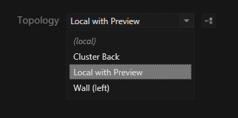

The topology editor always shows the currently active topology. Same as on the empty workbench, the topology editor's toolbar contains a drop down box where all available topologies are listed. In the image above, the automatically generated default topology "(local)" is selected. It consists of one channel slot, one cluster, two views and various connections between them.

Machines are represented by a rectangular box with their IP-address and name next to it. The following shows a cluster of three machines in various states:
The same information is also available for machines that have been detected on the network but are not currently used in the topology: the list of available machines. This part of the topology editor is collapsed by default and can be opened by
clicking on the label "Available Machines" on the far right side of the topology editor. For a machine to be listed here, it has to have a running Ventuz Machine Service (VMS).
As will be seen later, the local machine has a special role and is never listed in the available machines list.
Further information about a machine is displayed when hovering the mouse cursor over the machine's name. In a similar fashion, information about the runtime is shown when hovering over the Ventuz Runtime icon.

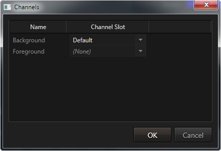

Each channel in a show has a channel slot ID it tries to connect to in the currently active topology when a show is opened. This connect is re-resolved whenever the channel is mapped to a different channel slot or the underlying topology changes (e.g. the operator switches to a different topology). The ID of a channel slot can be changed via its editing dialog by
double-clicking on a channel slot or via the edit entry in its context menu. The other end - the ID a channel is mapped to - can be changed in the Channel Manager which is accessed via Show / Channels in the main menu.

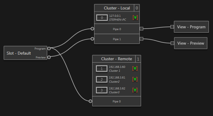

So while the preview outlet is optional, the program outlet is usually connected to Pipe 0 (the main output pipe) of one or more clusters by
dragging from the outlet to the port on the cluster. The example above shows a typical case: The local machine is serving as a rendering backend for the program and preview windows inside Director. The actual output for the audience is generated on a separate, three machine cluster which doesn't even need a preview pipe. It's Pipe 0 is also connected to the program outlet of the channel slot so the local and remote cluster both create the same visual output on their Pipe 0.

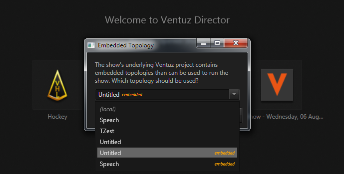

Starting with Version 4.05, Director can also embed topologies into a Ventuz project to make project deployment to a customer easier. Topologies can be embedded to or restored from a project via the main menu entry Show / Projects / Embedded Topologies.
When a user opens a show, Director will check the underlying project for embedded topologies. If it contains topologies, a dialog is opened that will allow the user to switch to one of the embedded topologies. He can also switch to an embedded topology after opening a show by using the respective entry in the Topology main menu.
When embedding topologies that use remote clusters, keep in mind that opening a show with such a topology will immediately start launching Ventuz runtimes on the remote machines. It therefore can make sense to embed topologies without any machines assigned as the user will have to save and modify them locally anyway.
