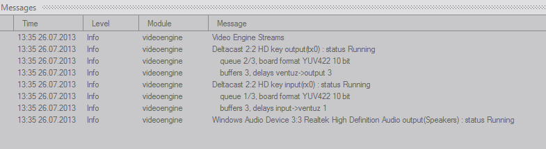

Input and output queues compensate short processing spikes. The more delay can be afforded, the longer the spikes can be without dropping any frame. (see Extra Buffers)
Ventuz can be configured to disable video processing automatically when the queues threaten to over- or underrun. In disabled mode, the video signal is passed without video processing, but still with the same delay, so seamless switching from full processing to disabled mode is possible. (internal keying modes)
Similarly, when switching scenes or projects, Ventuz might drop a few frames as new resources are loaded. A smooth transition can be guaranteed by manually disabling video processing before such operation and re-enabling afterwards.
This is useful for the various keying modes with Disabled Content set to Transparent. When the software watchdog detects that frames are about to be dropped, it provides transparent frames to the keyer, or in case of internal software keying the input frames are sent to the output unmodified. The fill will disappear but the background will not drop.
When using the Internal hardware keying with input and delay, the software watchdog must be enabled.

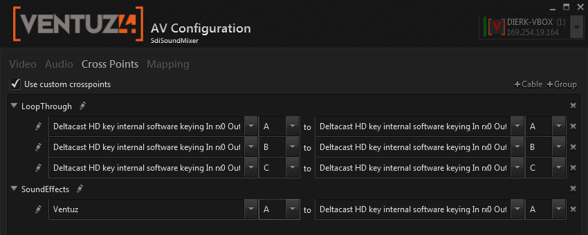

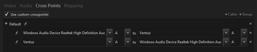

Virtual audio cables can be routed from any video input or Windows audio input device to any other video output or audio output device. Each cable comes with delay, volume and balance control.
Each stereo pair is handled individually, so routing from input 1 channel 5/6 to output 2 channel 1/2, or routing a 5.1 signal by using 3 stereo pairs is simple.
Ventuz can add sound clips or sound from video clips to the mix, or analyze sound from input sources. Similarly, audio can be delayed or compensated in order to match video or other delays.
The delay is for more than just adjusting for video input processing times. For some video formats, the number of samples changes from frame to frame, and input and outputs may be in a different position in the cycle of changing sample counts. For asynchronous streams, additional buffering is required. The delay will calculate a small but safe amount of buffering dependent on various attributes of the streams.
The virtual audio cables operate in stereo pairs. Each input or output has its certain number of stereo pairs (e.g. SDI has 8 pairs), and via the routing in the AV Configuration editor, the delays can be mixed and matched from input to output extremely flexibly.
An audio routing can handle multiple cables per input and output, with smoothing to prevent clicks or popping when changing volume or panning.
All audio processing in Ventuz is done at a sample level at 48kHz, and conversion to other sample rates is handled within the ffmpeg engine. Because Ventuz works with stereo pairs, 5.1 or devices with more outputs are simply divided into stereo pairs. Similarly, mono devices are converted into a stereo pair.

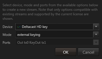

Video output streams are added by dragging a device from into the Outputs window. When doing so, a dialog pops up that allows users to specify some options:
In DirectX Output Mode only one output is supported since Ventuz always runs on a single GPU/Adapter. Combinations between DirectX-Fullscreen and SDI, for example, is not possible!
When configuring multiple inputs and outputs on the same card, arbitrary hardware limitations might reduce your choices.
If the configured output streams are only of type Shared Surface the outputs will be branded with a Ventuz logo if no appropriate License is available.

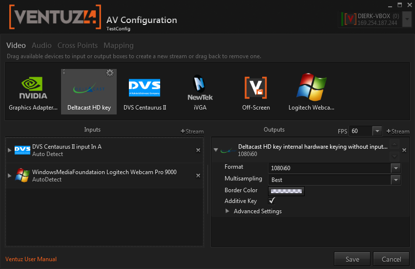

Video Device Information and Options
Each video device has two little buttons when hovering over the device icon.
The little 'i' will open a box with information about the hardware.
The little gear-icon will open a device configuration dialog. The selection of available options depends on the kind of the device and it's capabilities.
Available options are:
Genlock Source: Select the source for the ​genlock. Most SDI-boards support SDI-inputs and a special reference signal inputs. To disable genlock choose internal.
Genlock Format: Select the format of the genlock signal. Usually the genlock will lock on a signal much faster if it is not in Auto Detect mode.
Genlock H Offset and Genlock V Offset: (Live Option) This allows to offset output streams from the genlock signal. When the Genlock Format is not known, some boards only allow vertical (pixel) offset and no negative offsets. If the format is known, Ventuz can automatically convert (possibly negative) H & V offsets into a positive vertical offset independent from the boards capabilities.
Watchdog Timeout: (Live Option) Set the hardware watchdog of the device. The value is in milli-seconds. 0 disables the hardware watchdog. Do not confuse this device feature with the software watchdog.
Multi Channel: DVS boards can be switched between single and multi-channel modes. This usually happens automatically, but if there is some confusion, set it manually.
Video Norm Input X: Deltacast DVI capture boards require manual specification of the kind of signal to expect.
Preserve EDID: This tells Deltacast DVI capture boards to preserve a pre-programmed EDID (monitor id).
Verify Frame Rate: This is for Video for Windows inputs (like Webcams). When auto-detecting a signal, this verifies the frame rate. This is recommended, but disabling this may sometimes help locking on to input signals that are otherwise refused.
Auto-Detect 4k Modes: Some SDI boards receive 4k streams as quad-link HD or quad-link 3G streams. Unfortunately there is no standardized marker to distinguish a quad-link 4k streams from 4 normal streams. Normally, Ventuz will interpret a quad-link 4k stream as four independent streams. With this options Ventuz will assume that 4 identical streams will form a quad-link 4k stream if possible. Some streams can not form quad-link 4k, like interlaced or SD streams, these will still be handled as individual streams.

By pressing the Log button in the live options the current status of all streams (audio & video) is logged in the message window.
This information is only visible if the message level is set to info or debug. The message level can be set using the right mouse button popup menu.
For each stream, the name and some information is printed:
Status : the state of the stream. The following states are possible
Ready waiting for input signal, ready to go
Presync, Syncing stabilizing stream, synchronizing multiple streams together
Running stream is running normally
Disabled disabled either by the Live Video Node or by the software watchdog.
Bypass bypass relays activated
Error some error condition, see log for details.
Queue : The number of frames queued and the length of the queue. This should be a low number for input streams and a high number for output streams. If Ventuz is temporarily to slow, the input queue fills up and the output queue dries out. If Ventuz recovers in time and renders fast enough, input queues will slowly be emptied and output queues get filled, no frame will get duplicated on the output and no frame will get dropped from the input.
Board Format : When creating the stream, the video engine can be configured to prefer either speed or quality. This effects the selection of a buffer format to be used for sending and receiving data to the video board. What format is actually chosen depends also on the hardware capabilities and if an alpha (key) channel is required.
Name Bits Per Pixel Comment
YUV422 10 bit 21.3 best quality
YUV422 8 bit 16 best speed
YUVK4224 10 bit 32 best quality with alpha
YUVK4224 8 bit 24 best speed with alpha
RGBA 8 bit 32 used as quality option when YUVK4224 10 bit is not available
RGB 8 bit 24 used for some webcams (windows media foundation devices)
YUV422 8 bit with separate alpha 24 used for iVGA, same quality and speed as YUVK4224 8 bit
Generally, RGB(A) is sligtly better then 8 bit YUV(K) but worse and as slow as 10 bit YUV(K).
Buffers : The number of buffers allocated
Delay : The nominal delay of the stream. There are up to 3 kinds of delay:
Input -> Ventuz The delay from input to the Ventuz renderer
Ventuz -> Output The delay from the Ventuz renderer to output
Input -> Output The delay from the input and the output
For instance, in the internal hardware keying without input mode, the delay from input to output is typically zero or one frame, while the delay from ventuz to output is typically 3 to 4 frames. A zero delay is of course impossible, the deltacast keyer for example will shift the signal by around a hundred pixels. This counts as zero frames.

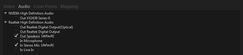

Audio Devices
In the Audio section displays all pure audio devices available in the system along with their supported streams (input and/or output). Simply selected the streams you want to use. The default Windows input and output streams are marked with the text (Default).
If portable devices such as USB headsets or USB speakers are used Ventuz will reports errors if the device is turned off or has been disconnected prior start-up of Ventuz. Some devices may change their stream configuration depending on the connected physical cabling. In such a case Ventuz will also report a missed stream on start-up.
Cross Points
In the Cross Points section, audio inputs and outputs can be connected. Such a connection always works on a stereo pair. A typical SDI device has 16 channels, and therefore 8 pairs. A sound-card configured for stereo has one stereo pair, one configured for 5.1 surround has 3 stereo pairs. In this manual the term Cross Point is also referred as Cable. These two terms are identical!
The Ventuz Video Engine does not support 3D or surround sound natively. Only PCM stereo is supported. The Sound 3D Node connects directly to a Windows 3D Audio Device without passing its audio trough the Ventuz Audio processing! Hence it is not possible to generate 3D sound and output it on SDI or other hardware of the video engine.
The Web Browser always outputs on the default Windows Audio device. Sound played by the Web Browser is not passed through the Ventuz Video Engine and is unable to be routed to SDI or other supported devices.
Stereo pairs are named A, B, C and so forth. Where A maps to the channels 1 and 2 (also referred as 1/2), B to 3/4, etc.
To enable Ventuz to interact with the audio a virtual Ventuz device exists. It provides 8 Record and 8 Playback stereo pairs. If Ventuz needs to receive audio from a stream (e.g. for the FFT Audio Analysis a cable from that stream has to be connected to a Record pair of Ventuz. If Ventuz outputs audio a Playback pair must be connected to the desired output stream or output streams. Any audio related node in Ventuz selects the Record or Playback pair to delegate the audio. The wiring defines how the audio is routed.
By default the Use custom crosspoints check box is unchecked. In that case Ventuz automatically subsequently connects the first stereo pair of all configured audio and video stream to the Ventuz Record Pairs. And all available audio outputs on all audio and video streams to the Ventuz Playback Pairs. All automatic cables are grouped is a single cable-group called Default. If the Use custom crosspoints is checked that cables have to created manually.
Ventuz works like a giant matrix mixer. Any input stereo pair can be mixed to any output stereo pair. In practice usually only a few such cross points are needed. Each line in the configuration represents one cross points. Each cross points consists of an input device with stereo pair and an output device with stereo pair.
Cross Points (or cables) are combined named groups. Inside Ventuz, the volume and stereo panning for each group can be automated by using the Volume Control Node. If many stereo pairs have to be automated in parallel, grouping them and giving the group a descriptive name can avoid confusion.
Please make sure that only one Volume Control Node controls a group at a time. Concurrent controlling would cause unexpected behavior. The rules here are last-in-last-out; the last access to the group in the current frame will set the parameters. If concurrent access happened within one render cycle a silent warning message will be logged.
Each cross point has its own Delay value. Although the default value is 0 it doesn't mean that there's no delay on the audio. The Ventuz Video Engine takes care about the minimum audio delay required to be in-sync with the video output. The user can adjust the delay value in milliseconds, but as long the actual minimum delay is not exceeded no additional delay will apply. The minimum delay depends on the entire structure of configured streams and is currently not displayed to the user.
Crosspoints Example: Adding Ventuz to SDI
Let's assume we don't have a hardware keyer (internal or external) that supports audio mixing. In this case, we must use the software keyer. This example shows how to pass through a 5.1 audio signal (not dolby) from SDI in to SDI out and add stereo sound effects from Ventuz.
The AV config for such an situation looks like this:
We have two groups: the first group (LoopThrough) loops the SDI audio input to the SDI audio output. The second one (SoundEffects) adds Ventuz audio in stereo to the SDI output. The volume of each group can be controlled with the Volume Control Node. For instance, one could duck the SDI loop-through before playing sound from Ventuz.
A common mistake is trying to loop SDI output through Ventuz. This will not work. Imagine working with normal audio equipment. Ventuz audio output is like a synthesizer. To add a synthesizer to the mix, one does not loop the signal through the synthesizer, the synthesizer is just connected to the mixer.
The SDI input is like a microphone input, and the Ventuz output is like the output of a synthesizer.
This is confusing. Instead of thinking in terms of inputs and outputs, think in terms of audio sources (left side of the cross-points window) and audio destinations (right side), from the perspective of a matrix mixer. So the Ventuz output is an input (source) to the mixer.

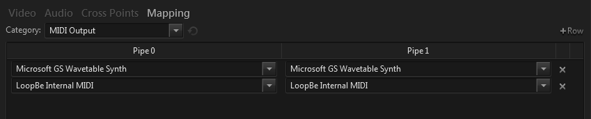

Device Mapping
The previous the areas of the AV Configuration defines audio and video, input and output streams. These streams as well other physical devices and logical devices (Ventuz virtual audio device) have to be mapped to the Nodes used inside a Ventuz scene.
The AV Configuration defines the physical order of all configured audio and video streams as well crosspoint groups, where Windows defines the physical order by the system's hardware enumeration API's.
The Mapping maps this physical order to a logical order used by Ventuz nodes. A Ventuz node that accesses a stream or device uses a so called Device Ordinal - a zero-based index that is passed through the Mapping for being resolved to the physical index of available devices. By default a one-to-one mapping is configured, so a logical device ordinal 0 maps to the physical device index 0, 1 to 1, 2 to 2, ..., 900 to 900. The mapping list is endless: every index is mapped to another one. If the physical device list has no device at its index - no device is returned and the node won't receive any input or won't output its data.
The endless mapping defines that even if for example no entry is visible at the 21st rows the 21st logical device ordinal will be mapped to the 21st physical device!
Logical Device Oridnals can be mapped to the following device and stream types:
Type Description Ventuz Nodes
Video Input Video Input streams Live Video
Audio Record Ventuz Record stereo pairs FFT Analysis
Audio Playback Ventuz Playback stereo pairs Sound and Audio, Movie
Audio Playback (3D Sound) Window Audio 3D Sound devices SoundSource 3D
Audio Crosspoints Audio Cross Point groups Volume Control
MIDI Input MIDI input devices MIDI Input
MIDI Output MIDI output devices MIDI Input
Serial COM Serial COM interfaces Serial Text
Gamepads Gamepads or Joysticks Joystick
Depending on the number of configured output pipes (video output streams), the device mapping shows one or two colums of mapping entries - one for each pipe. As said, the default mapping maps all indices one-to-one - the editor only displays the same number of rows as physical devices exist for the selected device type.
You can add more rows but as long as these rows do not change the default one-to-one mapping they won't be saved! If the configuration is loaded in the editor later these rows will be gone.
Example

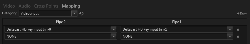

To configure the two output pipes so that each of them has its own live video input as its first device (ordinal 0) use the following mapping. Please note that the second row (ordinal 1) contains a NONE entry for both pipes, because the endless mapping would map ordinal 1 to device 1 if no explicit entry exists for ordinal 1. In this case both pipes would resolve to device 1 (Deltacast HD key input In rx1) on ordinal 1.
Multiple Logical Device Ordinals are allowed to map to the same Physical Device. Simple add a new row and select the physical device again.
Logical Device Ordinal can also map to a NONE device. No device will be address and the node will operate without device (no physical input or output)
The Reset button next to the device type selector resets all mapping entries. A list of all existent devices will be shown in the same order as they appear by the enumeration. A one-to-one mapping for all output pipes is the default mapping.
